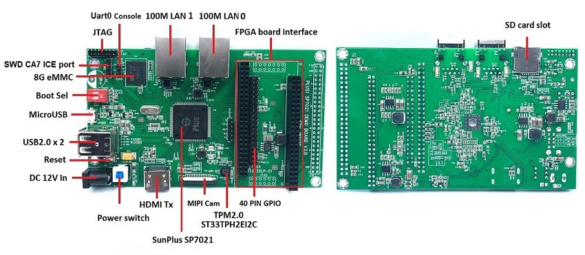

BPI Tech, a spinoff from SinoVoIP, has introduced a new single board computer with Banana Pi BPI-F2S powered by SunPlus SP7021 “Plus1” SoC with four Cortex-A7 cores, one older ARM9 real-time core, and one even older 8051 IO controller. The chip also embeds up to 512MB DDR3 memory.
The board comes an 8GB flash, dual Fast Ethernet, HDMI, a 40-pin Raspberry Pi compatible GPIO header, as well as headers for an optional Xilinx Artix-7 FPGA expansion board.
Banana Pi BPI-F2S SBC

  • SoC – Sunplus SP7021 “Plus1” with a quad-core Cortex-A7 processor @ 1.0 GHz, one Arm A926 microprocessor, an 8051 core to handle I/Os, and 128MB or 512MB DDR3 DRAM.
  • Storage – 8GB eMMC flash, microSD card slot
  • Video Output – HDMI 1.4 output
  • Camera I/F –  MIPI CSI connector
  • Connectivity – 2x 10/100M Ethernet
  • USB – 2x USB 2.0 host ports, 1x micro USB port
  • Expansion
    • 40-pin GPIO header compatible with Raspberry Pi header
    • 2x 50-pin FPGA interface for Trenz Electronic TE0725LP-01-100-2D  Artix 7 FPGA board
    • Undocumented 50-pin header that may be routed to the 40-pin RPI signals.
  • Debugging – 3-pin header for UART console, 10-pin JTAG header, SWD ICE port
  • Security – TPM 2.0 chip ST33TPH2EI2C
  • Misc – Power switch, reset button, boot selection dip switch
