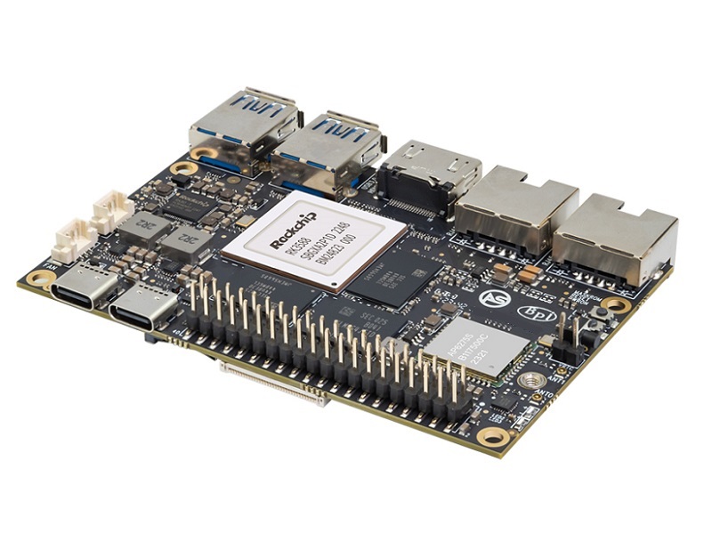

The Banana Pi BPI-M7 SBC is a Pico ITX Single Board Computer(SBC) powered by the Rockchip RK3588 SoC. The board includes an Arm Mali-G610 GPU, and a 6TOPS NPU, designed for high-performance computing, multimedia applications, and deep learning tasks. It supports up to 32GB RAM, and 128GB eMMC storage, and offers advanced display outputs and wireless connectivity.
If you’re interested in similar single-board computers (SBCs) that use the Rockchip RK3588 processor, you might want to check out these: BROADCOM Idea3588S, Indiedroid Nova, Radxa ROCK Pi 4, Orange Pi 5 Plus and some Banna Pi boards like the BPI-W3 and BPI-RK3588 They’re all worth looking into if you’re searching for SBCs with similar features.
The RK3588 is a quad-core Cortex-A76 (2.4 GHz) and Cortex-A55 (1.8 GHz) CPUs combined with an Arm Mali-G610 MP4 GPU for graphics processing. It also includes a 6 TOPS Neural Processing Unit (NPU) for efficient handling of AI and deep learning tasks, making it well-suited for a wide range of high-performance applications.
The Banana Pi BPI-M7 offers 8GB to 32GB RAM and up to 128GB eMMC storage. It supports 8K video decoding/encoding and a variety of formats like H.265 and VP9. It also features HDMI 2.1, USB-C, and MIPI DSI outputs for high-resolution displays. Additionally, The board’s NPU supports frameworks like TensorFlow and PyTorch.

The Banana Pi BPI-M7 model, equipped with 8GB RAM and 64GB eMMC storage, is now available for purchase at $165.00 on AliExpress and Youyeetoo. A Getting Started guide for this version is also accessible for users.
