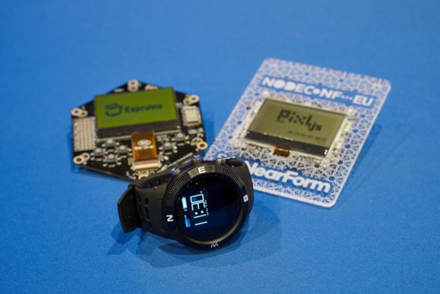

Bangle.js is the first hackable open source JS and TensorFlow-driven smartwatch. NodeConf EU 2019. Kilkenny, Ireland. November 2019. Photo by Nico Kaiser
The smartwatch is a product of NearForm trying to top their previous NodeConfEU badges and was developed by the NearForm Research team in partnership with Gordon Williams.
Not just your ordinary smartwatch, Bangle.js runs the recently release TensorFlow Lite for microcontrollers which means users can not only develop javascript applications, but they can also develop ML-based applications for the watch. This comes in really handy as the goal, as described by NearForm, is to see things snowball into a community-driven Open Health Platform through which people can build their own health apps ( to run on the watch) and stay in control of their health data.
At the core of Bangle.js is the Nordic Semi Nordic Semiconductor NRF52832 SoC using the Bluetooth LE 4.2 Technology and a 32mbit flash. The device comes with an array of sensors including; a KX023 accelerometer, a single 3 axis compass, a BD 1668 heart rate monitor, and 2 zones on/off Holtek touch controller.  The display is made up of 240×240 Colour LCD, GPS is included using the U-box UBX-M8130 and three buttons are added for control with a buzzer for sound notification.
The Evolution of Bangle.js – Espruino conference badges of 2017, 2018 and 2019 at NodeConf EU 2019.
