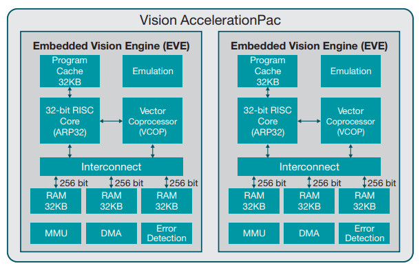

Just like the other BeagleBone SBC variants, the AM5729 has 4x programmable, real-time PRU cores. The AI SBC’s RAM is increased to 1GB and the eMMC storage is increased to 16GB compared to the BB Black. The board offers GbE and high-speed WiFi. It is also further equipped with a USB Type-A port and a USB Type-C port, which enables power and superspeed dual-role controller. According to BeagleBoard.org. The BeagleBone AI will offer BeagleBone Black header and mechanical compatibility, as well as a “zero-download out-of-box software experience.”
![](https://www.electronics-lab.com/wp-content/uploads/2019/03/ti_eve_arch.jpg)
The SBC will likely continue to run Linux and will ship with open specifications. BeagleBoard.org. Says the SBC is aimed at “everyday automation in industrial, commercial and home applications.” Information on pricing and availability are unknown for the BeagleBone AI, but you can sign up for notifications at the BeagleBone AI product page.
