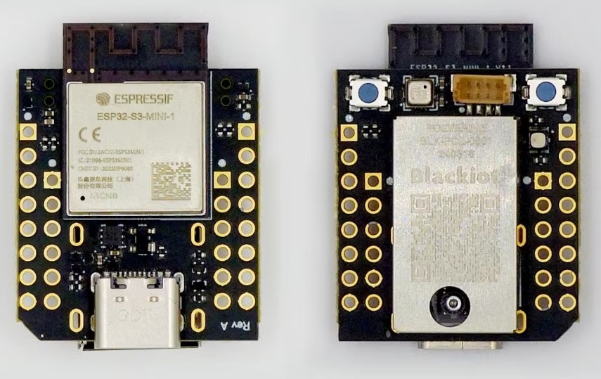

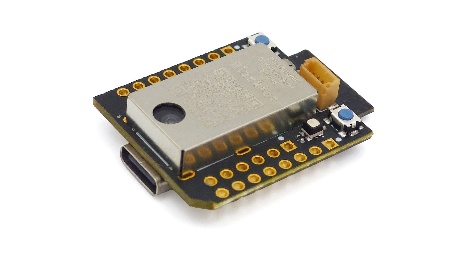

BlackIoT Polverine is a mikroBUS-compatible environmental sensing board designed for real-time air quality monitoring. It features the ESP32-S3-MINI-1 MCU, Bosch Sensortec’s BMV080 PM2.5 sensor, and BME690 gas sensor. The board supports Wi-Fi (802.11 b/g/n) and Bluetooth 5 connectivity and is available through the Crowd Supply crowdfunding platform.
The ESP32-S3-MINI-1, powered by an Xtensa 32-bit LX7 dual-core processor, enables reliable wireless communication. The BMV080, a compact 4.2 x 3.5 x 3 mm³ PM2.5 sensor, allows integration into ultra-compact devices. It features a fanless design for noiseless operation, reduced power consumption, and increased reliability.
The BME690 is a 4-in-1 environmental sensor that measures temperature, humidity, pressure, and volatile organic compounds (VOCs). With a 3.0 x 3.0 x 0.93 mm³ package and AI-based power optimization, it enhances Polverine’s sensing capabilities. By combining these sensors, Polverine provides precise environmental data in a compact and efficient design.

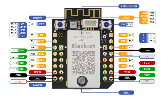

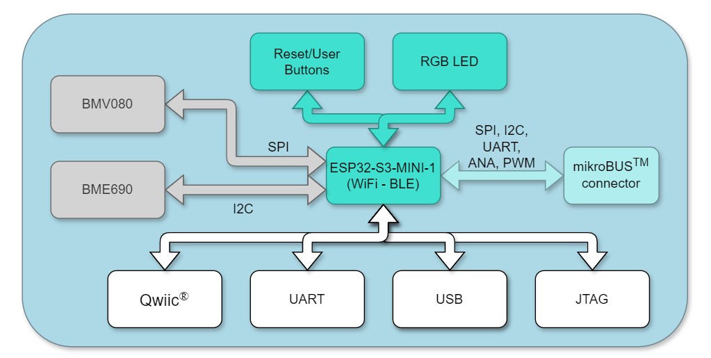

BlackIoT Polverine specifications:
  • Microcontroller:
    • Espressif ESP32-S3-MINI-1 with dual-core Xtensa 32-bit LX7 processor (240 MHz)
    • Memory: 0.5MB PSRAM
    • Storage: 8 MB Flash
    • Wireless: Integrated 2.4 GHz Wi-Fi (802.11 b/g/n) and Bluetooth 5 (LE)
  • Environmental Sensors:
    • Bosch Sensortec BMV080: PM2.5 particulate matter sensor
      • Ultra-compact 4.2 x 3.5 x 3 mm³ form factor
      • Fanless design for silent operation and lower power consumption
      • Measurement range: 0-1000 µg/m³, ±10% accuracy, 1 µg/m³ resolution
    • Bosch Sensortec BME690: 4-in-1 environmental sensor
      • Measures temperature, humidity, pressure, and VOCs
      • AI-enhanced gas sensing with customizable scanning
      • Compact 3.0 x 3.0 x 0.93 mm³ package
      • 50% more power-efficient than previous models
  • USB: USB-C connector for power and programming
  • Expansion:
    • USB, SPI, I2C, UART, GPIO/PWM, Analog IN
    • Qwiic Connect system for easy expansion
    • mikroBUS connector
  • Debug: JTAG debugging support
  • Misc: RGB LED, User/Bootloader button, Reset button
  • Security Features: Secure Boot and Flash Encryption
  • Power:
    • 5V USB-in
    • mikroBUS 5V pin
    • mikroBUS 3.3V pin
    • 5V supplied to LDO that outputs 3.3V
  • Dimensions: 25.4 mm x 28.6 mm (mikroBUS S size)
