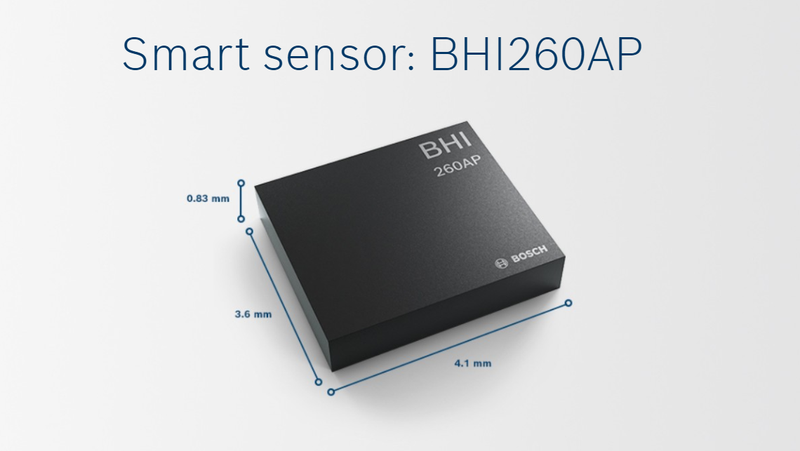

BHI260AP
The AI sensor is based around Synopsys’s popular ultra-low-power DesignWare ARC EM4 processors with ARCv2 16/32-bit instruction set clocked up to 3.6 CoreMark/MHz. The EM4 processor supports the floating-point unit and comes along with the memory protection unit. BHI260AP has an integrated 16-bit 3-axis accelerometer and gyroscope sensors.
