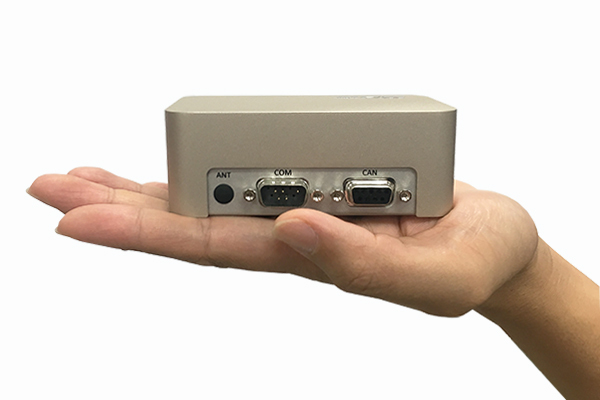

Aaeon has announced the release of the Boxer-8110AI embedded computer.  The Compact board which is similar to Aaeon’s Boxer-8120A which was released in May is based on the Nvidia Jetson Tx2 Module and is capable of running Linux distros like Ubuntu.
While it offers a more compact size (110 x 65 x 40mm), just like the Boxer-8120A, the Boxer-8110AI it comes with 8GB of LPDDR4 RAM, 32GB eMMC 5.1, and a MicroSD slot. The board also comes with communication support like the Gigabit Ethernet, HDMI, CAN and Serial Communication.
Designed for industrial applications, to meet the physical requirement of industrial environments, the board comes with anti-vibration features (3 Grms/ 5 ~ 500Hz/ operation – eMMC), supports /tolerate extreme temperature levels between the range of -20 to 50°C with 0.5 m/s AirFlow according to IEC60068-2 for Industrial Device, withstand humidity values up to 95% @ 40°C non-condensing, and comes with CE and FCC Class A certification ensuring it won’t be a source of disruption to other systems.
