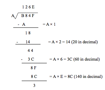

Hex Division
Division in hex is identical to division in decimal, except that we need to convert hex to decimal and perform long division in decimal, then convert back once complete. A hex division example is given below.
