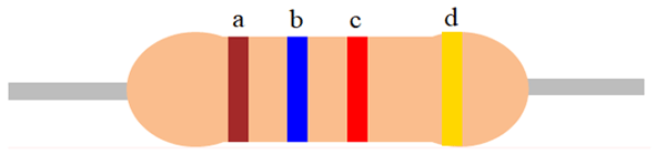

Calculating resistance for a 4-band resistor
![](https://www.electronics-lab.com/wp-content/uploads/2022/11/resistor-color-code.png)
![4 band resistor calculation formulae](https://circuitdigest.com/sites/default/files/inlineimages/resistance-calculation.png)
4-Band | Name | Description |
1st Band | a | 1st significant digit |
2nd Band | b | 2ndsignificant digit |
3rd Band | c | Multiplier |
4th Band | d | Tolerance |
