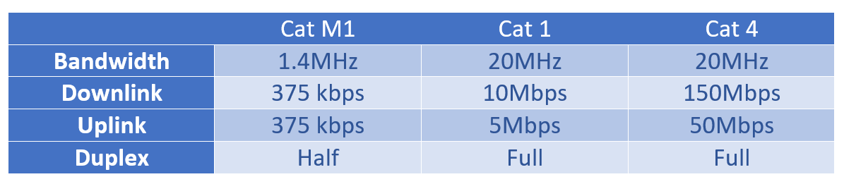

A Comparison of throughput: Cat M1 vs Cat 1 vs Cat 4
Cat M1, which also goes by the name LTE Cat M1 originally was designed specifically for IoT Solutions, with an average upload and download speed of 375 kbps. There is a trade-off between lower data range and the signal rate, where in the lower data rates enable the signal to travel further, allowing for devices to be positioned in remote locations.
Cat 1 supports higher data throughput of 10Mbps, enough for a majority of telematics and IoT applications. Cat 1 offers better global coverage while supporting low latency for wake-up applications. The major attraction is that it’s already standardized, and more importantly, it’s simple to transition into the Cat 1 network
Cat 4 modems can scream data at rates of up to 50Mbps upload and 150Mbps download speeds, which are essentially the same speeds consumers get on their smartphones.

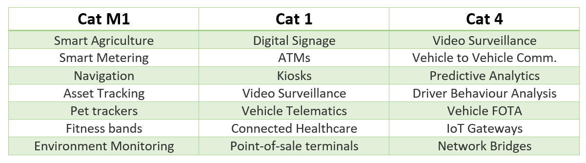

Use Cases: Cat M1 vs Cat 1 vs Cat 4
If your IoT use case involves maintaining an “always-on” connection between your devices and your application cloud, then a Cat 1 or Cat 4 modem is better suited for your device.
When Cat M1 technology is fully deployed, LTE for IoT will spread to the numerous types of very low throughput, very low power consumption applications such as industrial sensors, asset trackers, or wearables that wake up periodically to deliver only very small amounts of data and then go back to sleep. Cat M1 was designed primarily for efficiency. If the end application needs transmitting large data, constant connection, or high speed, then Cat M1 won’t be viable.
Cat 1 is believed to be the ideal solution for scenarios that are not dependent on high-speed data transmission but still require the reliability of the 4G network, and Cat 4 finding in a fit where there are no power budget constraints, and a requirement for high data throughput.

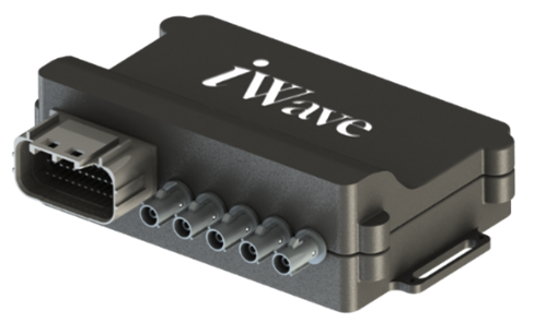

iWave Telematics Portfolio: Cat M1 & Cat 4 Telematics Units
Enabling customers to unlock value across a range of connected fleet, iWave supports customers with a Telematics Control Unit and Telematics Gateway. The telematics hardware is compatible with Cat M1 networks or can be configured to support Cat 4 networks, with the modem configuration an assembly configuration, making the device compatible to multiple connectivity technologies.
Integrating a pre-certified connectivity modem, which has been certified across geographies such as FCC, CE, GCF & TELEC, and network operator certifications such as VERIZON, AT&T, TELSTRA, VODAFONE makes the iWave telematics unit easier to certify dependent on the geographic certification requirements.
The telematics hardware is integrated with 3 CAN Ports, IMU Sensors, Ethernet, Analog Inputs with the support for various wireless technologies such as LTE, Wi-Fi, and Bluetooth. iWave supports telematics service providers with rugged and reliable telematics hardware. We design and manufacture telematics control units, telematics gateway and V2X Connectivity Solutions to cater to the growing telematics applications.
