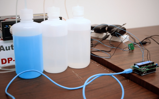

Researchers at Stanford University have just invented a revolutionary way of communication. They are replacing the conventional way of wiring, wireless, radio and Bluetooth connectivity using chemicals that can be found in every house.
Nariman Farsad, now a postdoctoral fellow at Stanford, had built the first ever experimental chemical texting system in York University, which used vodka to send its messages.
While making research in the lab of Andrea Goldsmith, professor of electrical engineering, he and his fellow researchers have built a machine that sends messages using common chemicals. With the use of vinegar and glass cleaner, Farsad overcomes some hurdles he faced while sending data using vodka. In his vodka messaging machine, the signal would build up to the point that the receiving end was too saturated with vodka to receive more messages. Instead, easy to obtain chemicals like vinegar and glass cleaner could do better and plus these two specific liquids can cancel each other out at the receiving end of the system.
This system is extracting one and zero bits out of liquid since it sends pulses of acid (vinegar) or base (glass cleaner). After typing the message in a small computer, it will be send to a machine that pumps out the corresponding “bits” of chemicals, which travel through plastic tubes to a small container with a pH sensor. Changes in pH are then transmitted to a computer that deciphers the encoded message.
