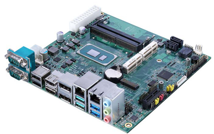

Taiwan Commate Computer Inc .(COMMELL), the worldwide leader of Industrial Single Board Computers, unveiled LP-179 & LV-6712 Mini-ITX based on Intel® 11th Gen. FCBGA1449 “Tiger Lake UP3”.
The 11th Gen Intel® Core™ processor is claimed to deliver better performance up to a 23% gain in single-thread performance, and up to a 19% gain in multi-thread performance vs. 8th Gen Intel® Core™ processors, up to 96 graphics execution units, deliver high-performance CPU/GPU compute with integrated AI acceleration, plus capabilities for applications that demand high-speed processing, and low-latency deterministic computing.
The COMMELL LP-179 & LV-6712 platform provides excellent CPU, graphics, media performance, flexibility, and enhanced security, is ideally suited to applications requiring multi-tasking capabilities, such as gaming, surveillance, medical, defense, transportation and industrial automation application.
LV-6712
The LP-179 & LV-6712 Mini-ITX is designed for the 11th generation Intel® Core™ i7-1185G7E and Celeron® 6305E, The Core™ i7 part has a 1.8GHz base clock with 12MB cache and a 4.4GHz max turbo frequency, The Core™ Celeron part has a 1.8GHz base clock frequency with 4MB cache, both CPUs offer long-life availability.
The LP-179 features one DDR4-3200 SO-DIMM slot for up to 32GB of memory. LV-6712 features two DDR4-3200 SO-DIMM slot for up to 64GB of memory.
LP-179 Displays one HDMI, one DP ports onboard, optional LVDS interface by ADP-3460 module. Lp-179 offers 2 x USB2.0, 2 x USB3.2 Gen2 and 1 x SATAIII, equipped with one Gigabit Ethernet,
and one 2.5Gb Ethernet,(1 x Intel® I219-LM Gigabit PHY LAN and 1 x Intel® I225-LM 2.5 Gigabit LAN), and comes with internal 2 x RS232,1 x HD Audio, 1 x M.2 Key M 2280 for support PCIe Gen4 device such as NVMe, 1 x M.2 Key E 2230 for Wi-Fi & BT module, Standard 12V DC input.
LV-6712 Displays LVDS, two HDMI and two DP ports onboard, up to four displays can be controlled simultaneously.
LV-6712 offers the features as 4 x USB2.0, 4 x USB3.2 Gen2 and 2 x SATAIII, equipped with one Gigabit Ethernet, and one 2.5Gb Ethernet,(1 x Intel® I219-LM Gigabit PHY LAN and 1 x Intel® I225-LM 2.5 Gigabit LAN), 2 x RS232/422/485 onboard and comes with internal PS/2 port, 4 x RS232,1 x 8bits GPIO, 1 x HD Audio, 1 x SMBus, 1 x M.2 Key M 2280 for support PCIe Gen4 device such as NVMe, 2 x MiniPCIe(slot 2 support mSATA), 1 x PCIe X1 slot, Standard 24-Pin ATX or 4-Pin 9~35V DC input.
