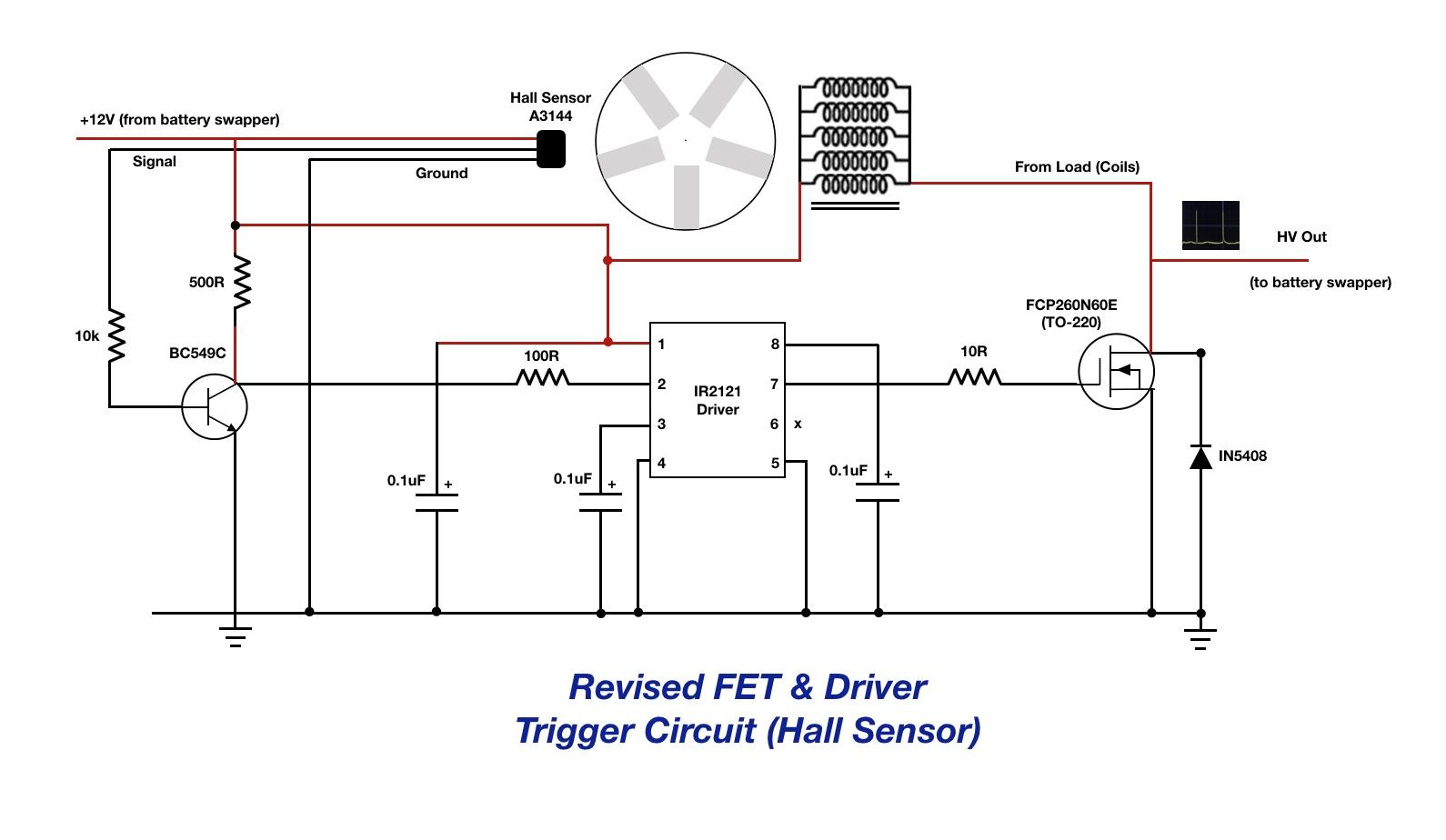

I have built a circuit for which the aim is to produce high voltage back EMF spikes from the Drain of a MOSFET so I can investigate some of the properties of these voltage transients.
What I have built is shown in the attached circuit where I am using an IR2121 driver chip to encourage shorter shut off times and so produce higher voltage spikes. Going from a circuit that didn't use a driver chip to one that does has increased the voltage from about 800V to 1,040V as shown in the scope image using a 10:1 voltage divider.
I have read that there are ways to further reduce the FET shut off time but as electronics is not my main discipline I find them rather confusing. For example, reducing the Gate bias resistor (R5) further (to 5R?) or putting a small capacitor (1nF?) across R5 and keeping the PCB track resistance from R5 to the Gate of Q2 as short as possible.
I would appreciate any suggestions.

They often use a diode across your R5, I gather to discharge the gate capacitor to speed it up. See this link and click on the "simulate transient" for the IPP60R099CP.
https://design.infineon.com/tinademo/designer.php?path=EXAMPLESROOT|INFINEON|Applications|Industrial|Power|&file=power_MOSFET_compare_450V.tsc&act=change.U.Infineon.IPP60R099CP_L0
I wonder if the turn off delay of the 555 propagates through the circuit? The 555 off time is 2us compared to the equivalent timer 1455 at 100ns.

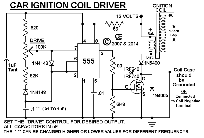

I am not sure about their graph either. You could try  playing around with a capacitor but I am  not sure how much  it affects the voltage drop rate at the output. As you are 95% there why not use an electronic ignition circuit? There are numerous  circuits like this one on the internet. You could get up to a few thousand volts then!1320123097_Car-Coil-1schemetic.png.208d110655708293d77166fa574bf990.png

Is the pulse width large enough for the coil current to reach maximum? I would think current should get to something like (12v - mosfet saturation voltage)/Rcoil.  Also the break down voltage of the mosfet and its diode may come in to play at high voltages?
for others:
Posted
The MOSFET is rated at 600V Vds and my D1 (1000V breakdown) is there to offer some protection (I think). So far the FET runs nice and cool and seemingly unperturbed.

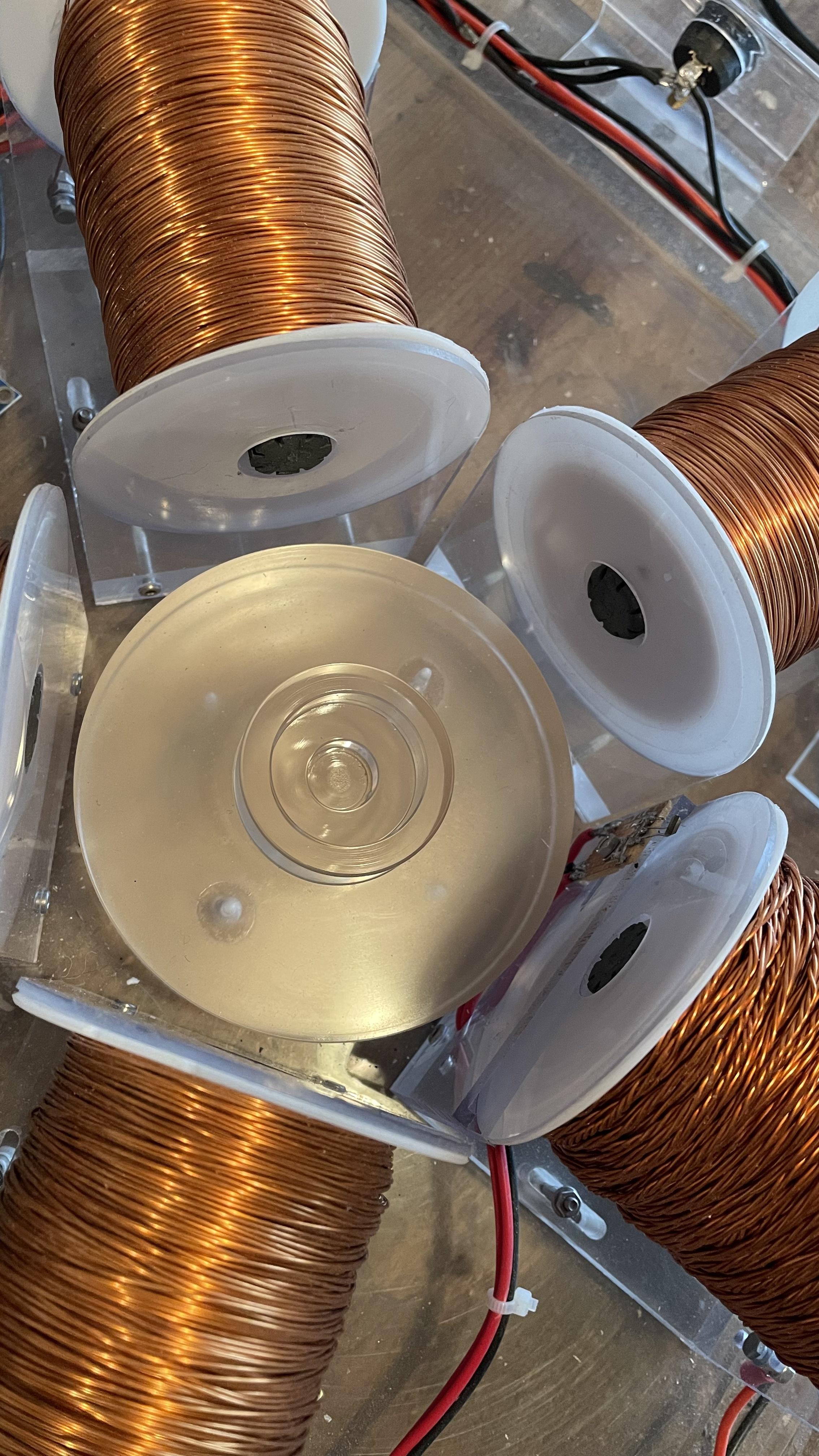

If you are referring to the pulse width from the 555 then they are 50% duty cycle pulses as often with a PWM setup. Each solenoid coil has a resistance of about 10Ohms from memory and there are 5 in parallel (see pic). My maximum current using the 555 trigger is about 1.75A. When using the rotor based hall sensor then about 0.6A (surprisingly, but this value is very dependent on the positioning of the Hall sensor - as with the ignition timing on an ICE).

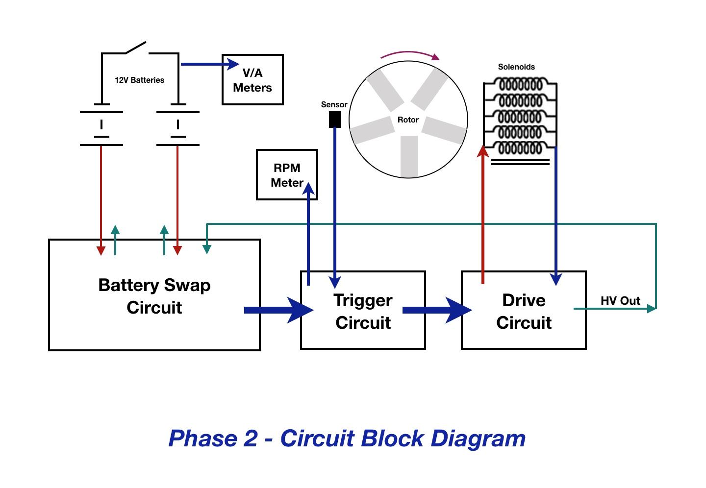

It will be useful to you to see a diagram depicting the whole circuit and the Hall sensor option (attached) so you can see how the trigger circuit relates to the whole.

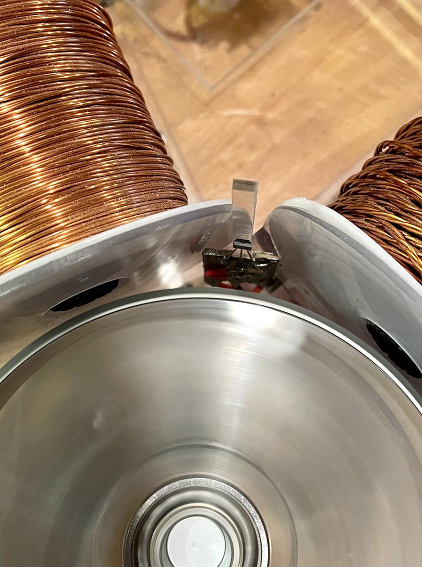

As mentioned I can trigger the FET (FCP260N60E in fact and not an IP160R099) to produce its 1,000V back EMF pulses at 100-5kHz using the 555 based internal trigger system or the rotor/Hall based system where it will reach a pulse repetition frequency of about 200Hz. The graphic shows the Hall sensor option but the Trigger circuit has the timer option built in at the flick of a switch.

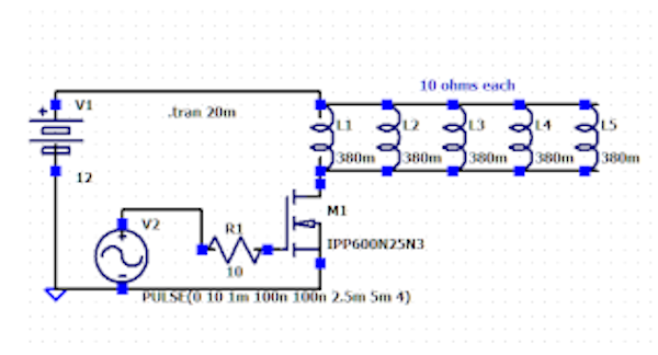

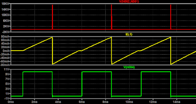

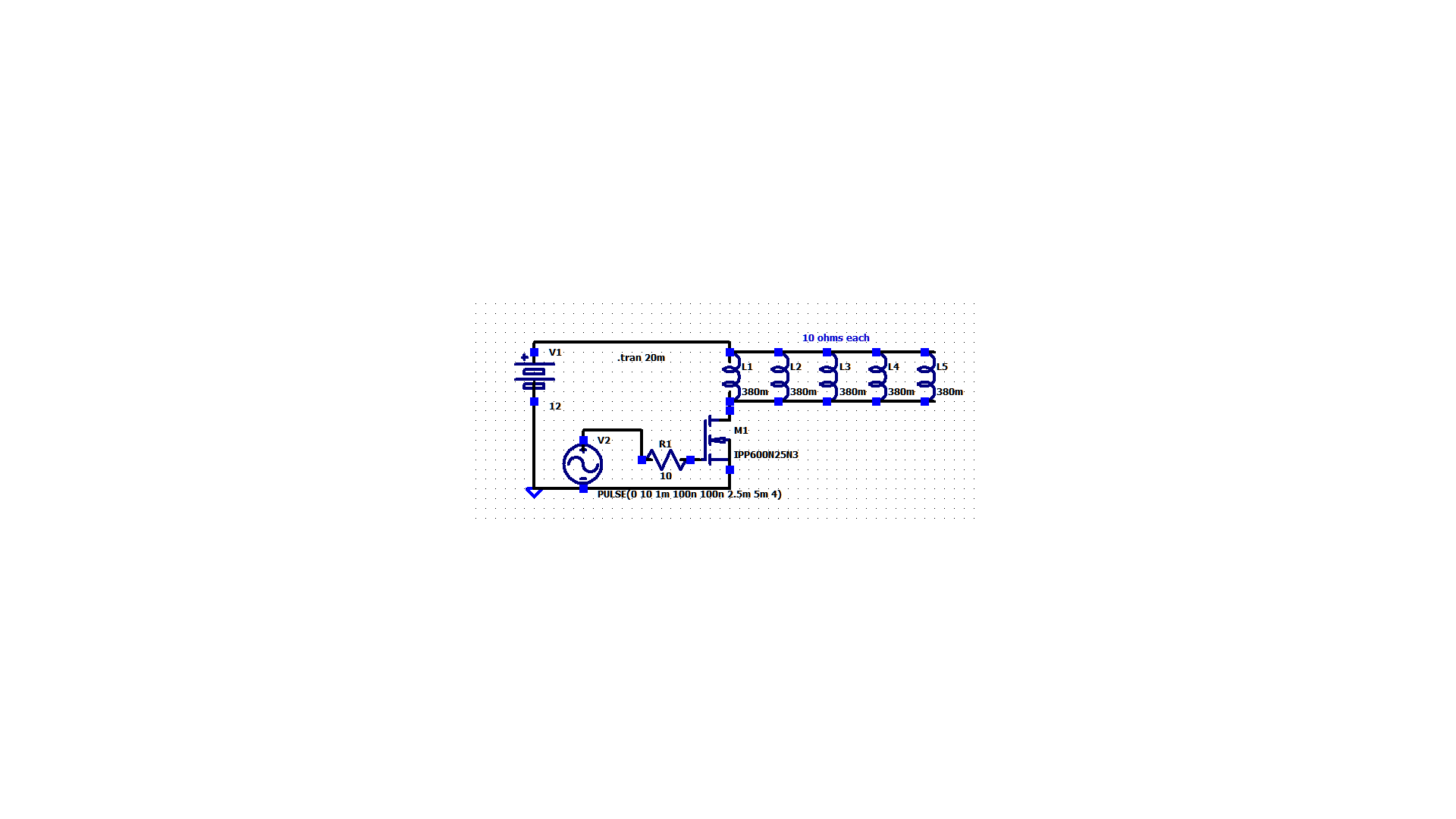

Using the circuit below with  an 2.5ms wide pulse at 10v  with rise and fall times of 100ns in the simulator I get the wave forms below.
The green trace is the input at the base of the mosfet, the yellow trace is the current through one of the coils while the red trace is the voltage across the coils.  I will try increasing the pulse width until the current reaches steady state and see what is looks like and post it later.
I do not understand the current.
Posted
That’s fascinating but look at the spikes - 18kV. I don’t see that in practice, more about 1kV. Would it be helpful if I showed you the actual scope trace for the gate of the mosfet?

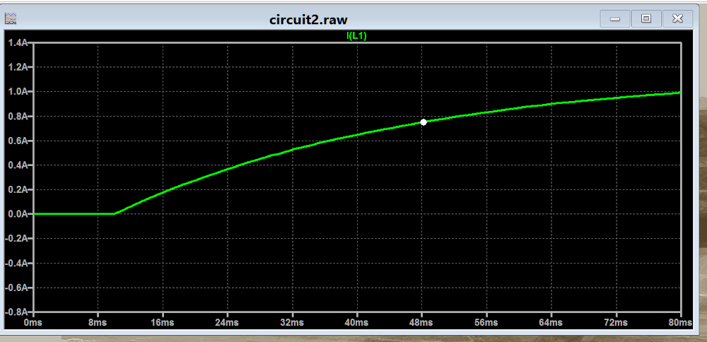

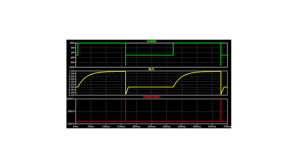

It takes in the order of 200ms for the current to reach maximum in the simulator. The current through one coil is about 1.18 amperes. The voltage across the coils is about 200kv - you better wear rubber boots! Perhaps the simulator got carried away.
There is an equation: time = inductance/resistance = 63% of the charge. So t= 0.380h /10 ohms would give 38ms. That would give 0.74amps at 48ms (38ms + 10ms pulse on delay) in the second waveform. That seems about right; at the white dot.

The link with Time is that V= L.dI/dt so the Voltage produced is determined by the rate of change of the current for a given Inductance.
If 200kV is what is coming out of the simulator then something is not quite right with what’s going in to it, or an assumption somewhere. 😬
