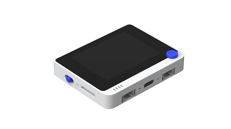

🧠 Wio Terminal
image_IeGtJBkbO1.png?auto=compress%2Cformat&w=740&h=555&fit=max
An all-in-one embedded board from Seeed Studio packed with features:
  • Display: 2.4” LCD for live feedback
  • Sensors: Built-in light sensor (A0) and microphone (A2)
  • Connectivity: Wi-Fi, BLE, USB-C, microSD slot
  • Processor: ATSAMD51 ARM Cortex-M4F @ 120 MHz
  • Easily programmable via Arduino IDE or CircuitPython
💡 Light Sensor
A photodiode connected to A0, sensing ambient light levels.
  • Range: Analog 0–1023 (via analogRead)
  • Perfect for tracking sunlight cycles, lighting conditions, or plant environments.
🔊 Microphone
An analog MEMS mic connected to A2 measuring sound amplitude—not full audio, just “how loud”.
  • Use it for detecting noise patterns, claps, spikes, and loud events.
  • Analog output—no speech recognition, but great for threshold alerts.

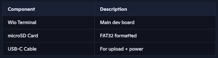

🪛 Hardware Checklist
image_U6bsTKMZQj.png?auto=compress%2Cformat&w=740&h=555&fit=max

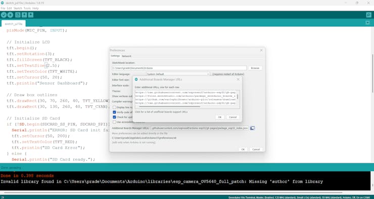

📦 Arduino Setup
Install Seeed Boards Add to Arduino Preferences: https://files.seeedstudio.com/arduino/package_seeeduino_boards_index.json
image_1yKHQer4Ow.png?auto=compress%2Cformat&w=740&h=555&fit=max

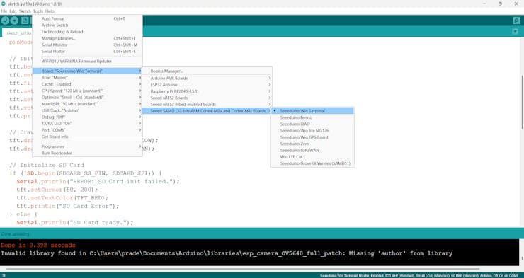

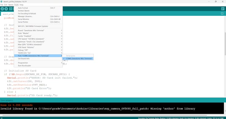

Select Board & Port
  • Board: Wio Terminal
image_nWgoKIuQbc.png?auto=compress%2Cformat&w=740&h=555&fit=max
  • Port: Your USB device
image_Qd5Cs3myiD.png?auto=compress%2Cformat&w=740&h=555&fit=max

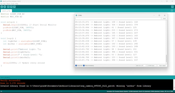

Step 1: Display Light & Sound Sensor Data via Serial
Use this simple Arduino sketch to read the Light and Sound sensor data then show it via Serial Terminal.

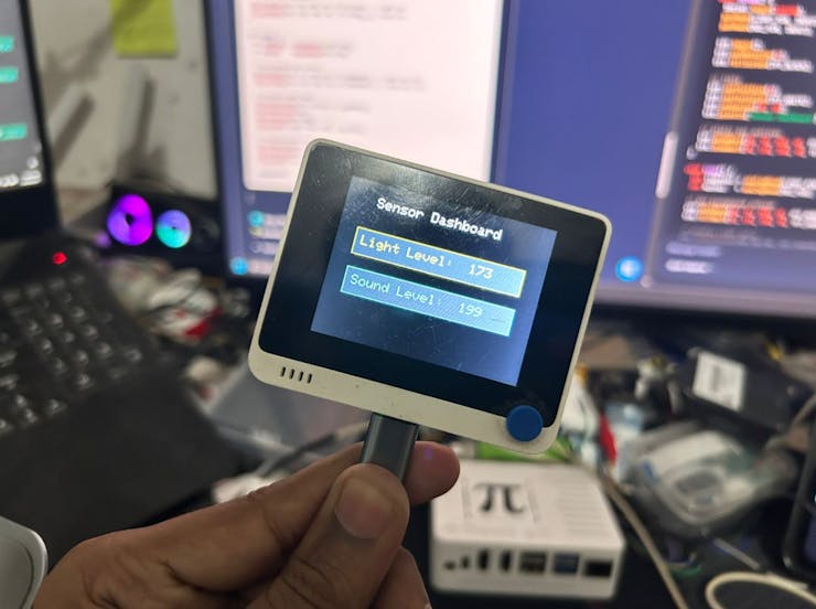

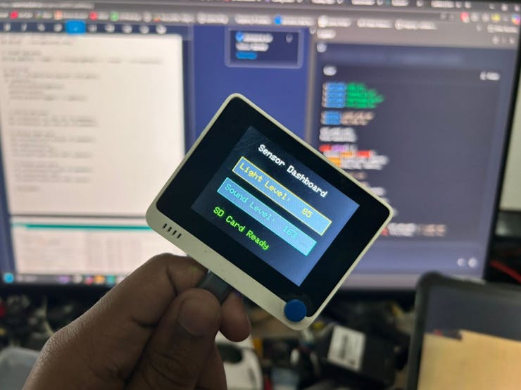

Step 2: Display Light & Sound Sensor Data via GUI
Here’s a detailed and clean Arduino sketch to create a graphical interface using the Wio Terminal’s LCD:

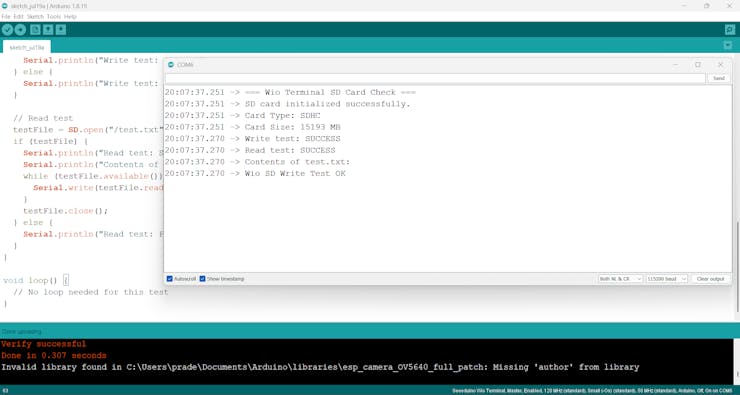

#include <SPI.h>
#include "Seeed_FS.h"
#include "SD/Seeed_SD.h"
File testFile;
void setup() {
  Serial.begin(115200);
  while (!Serial);  // Wait for Serial Monitor
  Serial.println("=== Wio Terminal SD Card Check ===");
  // Initialize SD card
  if (!SD.begin(SDCARD_SS_PIN, SDCARD_SPI)) {
    Serial.println("ERROR: SD card initialization failed.");
    return;
  Serial.println("SD card initialized successfully.");
  // Detect card type
  uint8_t cardType = SD.cardType();
  Serial.print("Card Type: ");
  switch (cardType) {
    case CARD_MMC: Serial.println("MMC"); break;
    case CARD_SD: Serial.println("SDSC"); break;
    case CARD_SDHC: Serial.println("SDHC"); break;
    default: Serial.println("Unknown"); break;
  // Show card size (safe casting)
  uint64_t cardSize = SD.cardSize(); // bytes
  Serial.print("Card Size: ");
  Serial.print((unsigned long)(cardSize / (1024 * 1024))); // in MB
  Serial.println(" MB");
  // Write test
  testFile = SD.open("/test.txt", FILE_WRITE);
  if (testFile) {
    testFile.println("Wio SD Write Test OK");
    testFile.close();
    Serial.println("Write test: SUCCESS");
  } else {
    Serial.println("Write test: FAILED");
  // Read test
  testFile = SD.open("/test.txt");
  if (testFile) {
    Serial.println("Read test: SUCCESS");
    Serial.println("Contents of test.txt:");
    while (testFile.available()) {
      Serial.write(testFile.read());
    testFile.close();
  } else {
    Serial.println("Read test: FAILED");

image_H5CfqCAnBD.png?auto=compress%2Cformat&w=740&h=555&fit=max

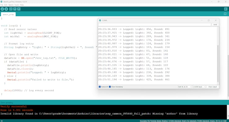

Step 4: Display Light & Sound Sensor Data via GUI record in SD
Here's a full Arduino sketch that reads the light and sound sensor values from the Wio Terminal and records them to an SD card file named env_log.txt every second. It’s modular, reliable, and ready for field deployment.
#include <SPI.h>
#include <TFT_eSPI.h>
#define LIGHT_PIN A0
#define MIC_PIN A2
TFT_eSPI tft;
File dataFile;
void setup() {
  pinMode(LIGHT_PIN, INPUT);
  pinMode(MIC_PIN, INPUT);
  // Initialize LCD
  tft.begin();
  tft.setRotation(3);
  tft.fillScreen(TFT_BLACK);
  tft.setTextSize(2.5);
  tft.setTextColor(TFT_WHITE);
  tft.setCursor(50, 20);
  tft.println("Sensor Dashboard");
  // Draw box outlines
  tft.drawRect(30, 70, 260, 40, TFT_YELLOW); // Light box
  tft.drawRect(30, 130, 260, 40, TFT_CYAN);  // Sound box
  // Initialize SD
    Serial.println("ERROR: SD Card init failed.");
    tft.setCursor(50, 200);
    tft.setTextColor(TFT_RED);
    tft.println("SD Card Error");
  } else {
    Serial.println("SD Card ready.");
    tft.setTextColor(TFT_GREEN);
    tft.println("SD Card Ready");
void loop() {
  int lightVal = analogRead(LIGHT_PIN);
  int micVal   = analogRead(MIC_PIN);
  // Format log entry
  String logEntry = "Light: " + String(lightVal) + ", Sound: " + String(micVal);
  // Log to SD
  dataFile = SD.open("/env_log.txt", FILE_WRITE);
  if (dataFile) {
    dataFile.println(logEntry);
    dataFile.close();
    Serial.println("Logged: " + logEntry);
  // Refresh GUI boxes
  tft.fillRect(31, 71, 258, 38, TFT_DARKGREY);
  tft.fillRect(31, 131, 258, 38, TFT_DARKGREY);
  // Display light value
  tft.setTextColor(TFT_YELLOW, TFT_DARKGREY);
  tft.setTextSize(2);
  tft.setCursor(40, 80);
  tft.printf("Light Level: %4d", lightVal);
  // Display sound value
  tft.setTextColor(TFT_CYAN, TFT_DARKGREY);
  tft.setCursor(40, 140);
  tft.printf("Sound Level: %4d", micVal);
  delay(1000);

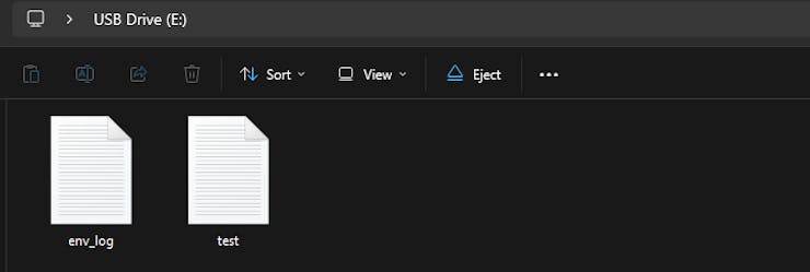

image_HiuDbUijym.png?auto=compress%2Cformat&w=740&h=555&fit=max
image_f6sxlXyL3m.png?auto=compress%2Cformat&w=740&h=555&fit=max

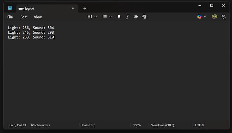

Now let's review the data in the excel file.

📈 Bonus: Visualizing the Data
After logging:
  • Remove the SD card, open env_log.txt
  • Save as .csv
  • Open in Excel or Google Sheets
  • Plot light vs sound values over time
You could even build time-stamp logic using an RTC or millis() and add thresholds to trigger alerts.
