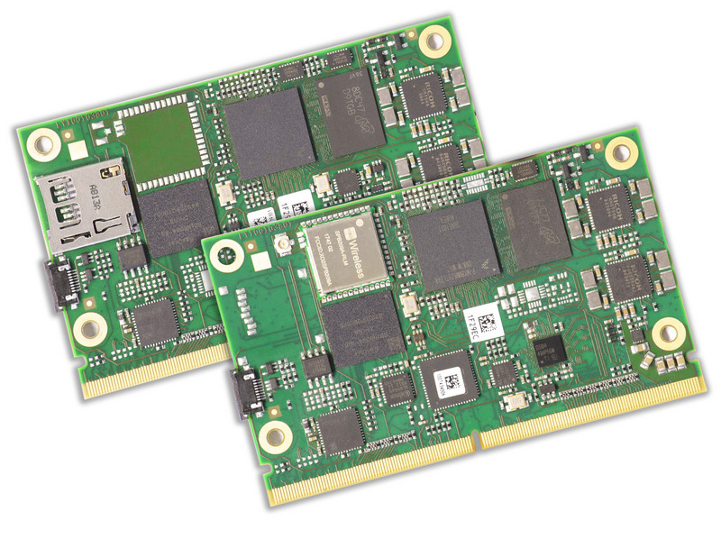

Avnet Integrated presents a new, cost-efficient MSC SM2S-IMX8MINI SMARC 2.0™ module, which is based on i.MX 8M Mini processors from NXP™. The multicore ARM® Cortex-A53 processors are built using NXP’s 14nm FinFET process technology, providing high compute performance at very low power consumption. With the standardized MSC SM2S-IMX8MINI compact SMARC 2.0™ module family and the appropriate starter kit, the new processor technology is easily and quickly available for innovative customer applications. The extremely versatile module family may be used in any general purpose industrial, IoT, building automation and media streaming application.
The MSC SM2S-IMX8MINI SMARC 2.0 module features high scalability and can be equipped with different single-, dual- or quad-core processor types. The flexibility of the new module family is comparable to the scalability of the i.MX 6 predecessor products. However, these modules offer significantly higher compute performance due to 64-bit support and fast LPDDR4 memory. The SM2S-IMX8MINI modules are designed not only for the new Mini processors, but also for the future pin-compatible Nano processors from NXP.
The new Computer-On-Modules (COMs), based on NXP’s powerful i.MX 8 processor family ‒ consisting of the i.MX 8, i.MX 8M and i.MX 8M Mini variants ‒ are suitable for embedded applications that requirethe highest degree of performance combined with high energy efficiency. Avnet Integrated will offer the complete i.MX 8 processor family on the persistent and future-proof SMARC 2.0™ and Qseven™ module form factors and further strengthen its leading position as a manufacturer of innovative embedded modules. In addition to providing hardware manufactured in Germany, extensive development tools such as starter kits and board support packages as well as personalized services including design-in support and carrier design review are offered.
MSC SM2S-IMX8MINI

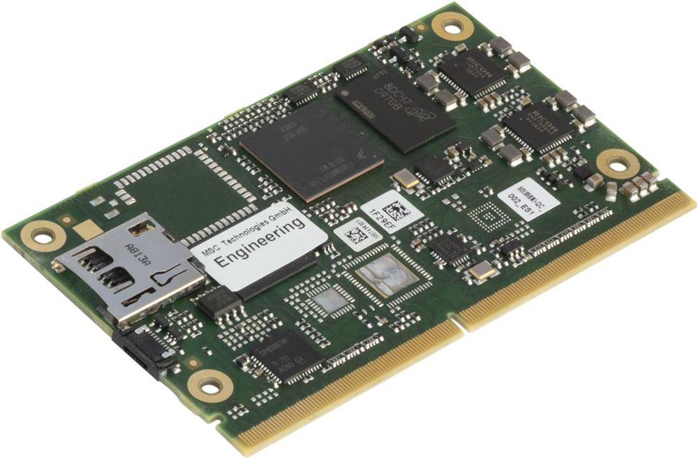

The MSC SM2S-IMX8MINI module features NXP’s i.MX 8M Mini processors that are based on latest 14nm FinFET technology to allow high computing and graphics performance at very low power consumption combined with a high degree of functional integration.
MSC SM2S-IMX8MINI offers single-, dual- or quad-core ARM Cortex-A53 processors in combination with the ARM Cortex-M4 real-time processor and GC NanoUltra multimedia 2D/3D GPU. It provides fast LPDDR4 memory, up to 64GB eMMC Flash memory, Gigabit Ethernet, PCI Express, USB 2.0, an on-board Wireless Module as well as an extensive set of interfaces for embedded applications.
The module is compliant with the new SMARC™ 2.0 standard, allowing easy integration with SMARC baseboards. For evaluation and design-in of the SM2S-IMX8MINI module, MSC provides a development platform and a starter kit. Support for Linux is available (Android support on request).
