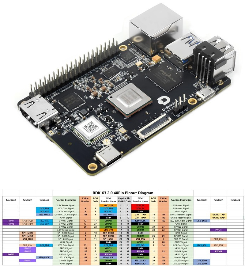

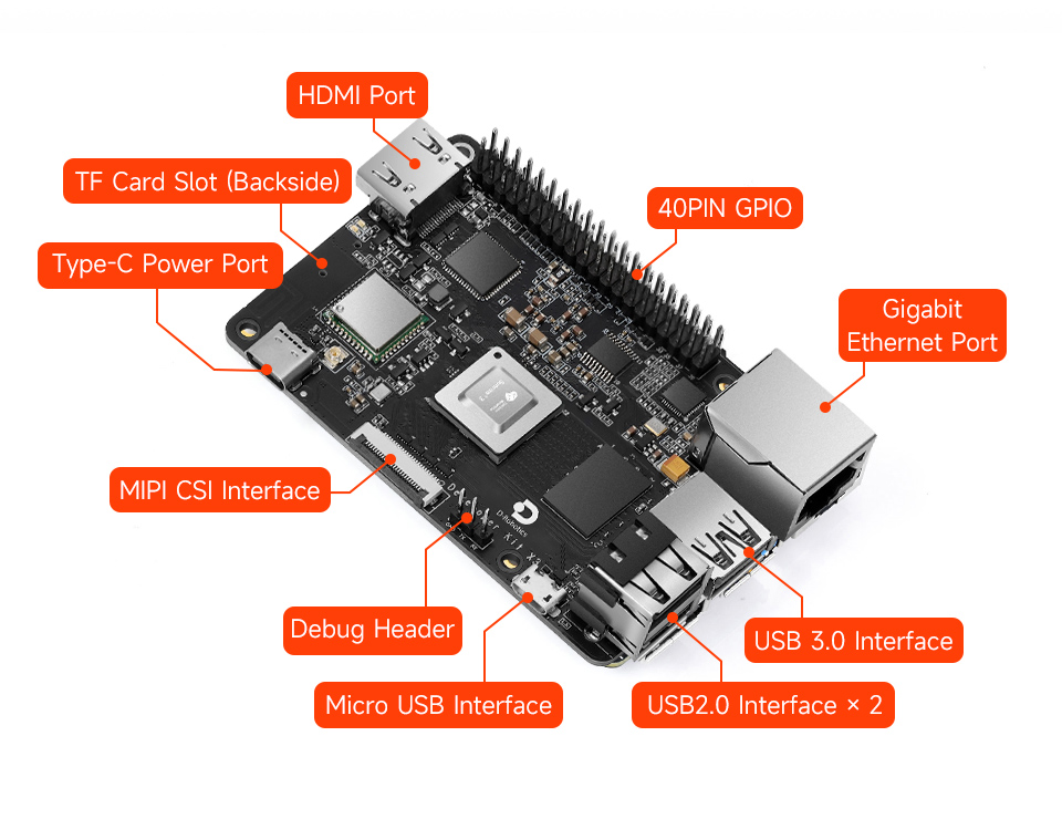

The D-Robotics RDK X3 dev board is specifically designed for edge AI applications, particularly in robotics. It utilizes the Sunrise X3 processor with a quad-core Arm Cortex-A53 CPU and a dual-core BPU (Brain Processing Unit) that features a 5 TOPS NPU for AI tasks. This makes it suitable for computer vision applications like object detection and image segmentation. Key features include 2GB or 4GB of RAM, a 40-pin GPIO for compatibility with Raspberry Pi accessories, and various connectivity options like Gigabit Ethernet and Wi-Fi/Bluetooth. The board supports Ubuntu and ROS, providing a robust platform for developers to create and deploy AI-powered robotics solutions.

RDK X3 dev board Specification
  • SoC: Horizon Robotics Sunrise X3
  • CPU: Quad-core ARM Cortex-A53 @ 1.5 GHz
  • BPU: Dual-core Bernoulli architecture with 5 TOPS for AI inference
  • Memory: 2GB/4GB LPDDR4 RAM
  • Storage: MicroSD card slot
  • Display:
    • 1x HDMI 1.4 up to 1080p60
    • 1x MIPI-DSI up to 1080p60
  • Camera: 2x 2-lane MIPI CSI for camera sensors
  • Networking:
    • Gigabit Ethernet RJ45 port
    • Wi-Fi 2.4/5GHz and Bluetooth 4.2 module
    • 1x U.FL connector for external antenna
  • USB:
    • 1x USB Type-A 3.0
    • 2x USB Type-A 2.0
    • 1x Micro USB 2.0
    • USB Type-C for power input
  • Expansion: Dual line 40-pin header compatible with Raspberry Pi 4B accessories (GPIO, I2C, UART, SPI, I2S and PWM)
  • Misc: 1x UART for debug serial port, 1x power LED indicator, 1x Green LED connected to GPIO26
  • Power: 5V/3A DC-in via Type-C port
  • Dimension: 85 × 56 × 20 mm
  • OperatingTemperature: -25°C ~ 95°C
