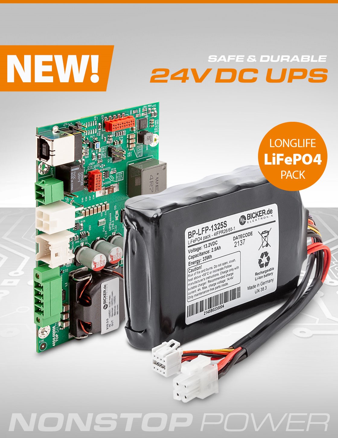

The new DC UPS solution UPSI-2406 + battery pack BP-LFP-1325S can be flexibly integrated into a wide range of applications to protect sensitive or safety-relevant systems in case of power failure, voltage dip or flicker. The 24V DC emergency power supply ensures fail-safe operation in an emergency and prevents data loss.
All advantages at a glance
  • Integratable 24VDC emergency power supply
  • Ideal for long bridging times: 600 min (2W) – 25 min (70W) – 10 min (150W)
  • 10-year battery pack LiFePO4
  • USB & RS232 interface and relay contact
  • UPS management software included
  • Shutdown & Reboot function for IPC
  • Extended temperature range -20 to +55°C
  • IEC 62133-2 safety approval
  • UN 38.3 Transport certificate
The LiFePO4 energy storage (lithium iron phosphate) with 33 Wh convinces in safety-relevant applications with a particularly stable battery chemistry, a long service life of at least ten years and more than 6,000 full charge and discharge cycles. Bicker Elektronik deliberately relies on the particularly safe lithium iron phosphate chemistry for all high-performance battery packs, which makes thermal runaway almost impossible.
The new UPS management software ‘UPScom’ with cross-platform technology and intuitive user interface offers extensive functions for monitoring, parameterisation and messenger services.
Intuitive user interface and extensive functionality
The software ‘UPScom’ allows the connected devices to be shut down and switched off in a controlled manner during a power failure in order to avoid data loss or damage. The responsive WEB UI is called up in a web browser to set and pre-program all parameters of the DC UPS system and for real-time monitoring with state-of-charge indicator. The adjustable parameters include, among other things, load sensor (mA), shutdown delay, maximum backup time, minimum charge capacity before system start, notifications by email.
Cross platform technology
‘UPScom’ uses the new WebAssembly (WASM) architecture, which runs in most current web browsers. ‘UPScom’ runs on x86 compatible systems and also on most ARM-64 based systems under Microsoft® Windows and various Linux distributions.
Secure Shutdown & Reboot function for IPC systems
In the event of a “power failure”, the UPS signals the failure of the supply voltage via the integrated USB or RS232 interface, so that a controlled shutdown of the computer system is initiated and valuable data is saved. A script (batch) can also be executed before the system is shut down in order to process your own application-relevant processes. The integrated reboot function of the DC UPS automatically restarts the supplied IPC after the supply voltage returns, without the need for time-consuming on-site intervention by a service employee, e.g. in the case of completely self-sufficient computer systems at inaccessible locations.
Email messenger service
‘UPScom’ can be used for various events such as loss of connection to the UPS, system shutdown or power failure. These preventative measures can reduce or eliminate downtime.
