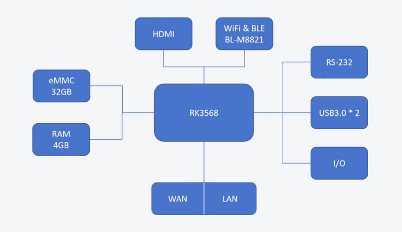

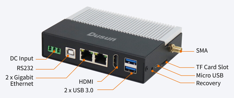

  • SoC: Rockchip RK3568
    • CPU: Quad-core Cortex A55 processor at up to 2.0 GHz
    • GPU: Mali G52 GPU with support for OpenGL ES 1.1/2.0/3.2, OpenCL 2.0, Vulkan 1.1
    • VPU
      • 4Kp60 H.264, H.265, VP9, 1080p60 MPEG-4/-2/-1, VP8, and VC1 video decoder
      • 1080p60 H.264/H.265 video encoder
    • AI accelerator – 1 TOPS NPU
  • RAM: 4GB LPDDR4
  • Flash Storage: 32GB eMMC
  • Video: HDMI port 4K @ 60Hz
  • Audio: No Audio out port you need to use HDMI audio.
  • Power Input: DC 24V (3-way Phoenix header, wide voltage input 10~28V DC)
  • Ethernet:
    • 1000Mbps WAN port
    • 1000Mbps LAN port
    • RJ45 terminal
  • USB Ports:
    • 2 x USB 3.0 Type-A
    • 1 x Micro USB (for upgrade)
  • RTC: Supported
  • TF Card Slot: 1 TF card slot
  • Antenna: 1 SMA, for WiFi 2.4GHz + Bluetooth
  • RS-232: 1 RS-232, Type-A terminal
  • GPIO: 8
  • Recovery Button: Supported
  • VNC: Supported

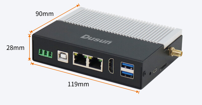

  • Size: 119 x 90 x 28 mm
