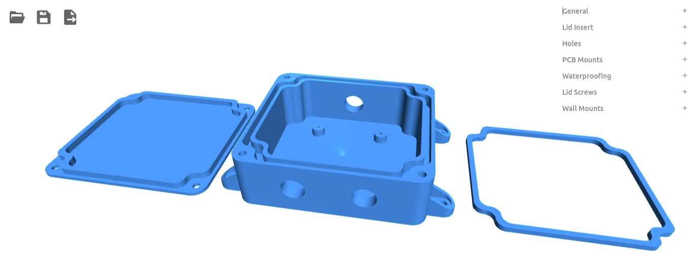

3D printing is everywhere, from complex prototypes to simple DIY projects. To meet your design and prototyping needs, you need good 3D design software and the skills to use it. However, the challenge is that even with a design idea, you might struggle to create it due to the difficulty of using the design software. This is where EasyEnclosure becomes useful.
EasyEnclosure is an open-source 3D modeling software tailored specifically for designing 3D-printable enclosures. It aims to provide an intuitive interface and a set of user-friendly controls that allow even those with little or no 3D modeling experience to create custom enclosures for their electronic projects, prototypes, or DIY gadgets
EasyEnclosure offers an array of customization options, including basic square enclosures, configurable dimensions, wall thickness, rounded corners, and much more. It even includes options for waterproof seals and PCB mounts, ensuring a comprehensive solution for various project needs.
Built on a robust technology stack including TypeScript, React, and JSCAD, EasyEnclosure combines performance with reliability. The tool is hosted on GitHub. Its ability to export designs in STL format makes it compatible with a broad range of 3D printers.
As an open-source project, EasyEnclosure encourages community participation. Users can support the project through donations or by contributing to its development via pull requests. The team also welcomes users to test prints with different settings and report any issues, aiding in the software’s continuous improvement.
The roadmap for EasyEnclosure includes exciting upcoming features such as predefined templates for common devices like Raspberry Pi and Arduino, DIN rail mounts, and the ability to export each entity separately. The extended list of upcoming features can be found on the EasyEnclosure GitHub repository.

  • User-Friendly Interface: It provides an intuitive platform suitable for users with varying levels of 3D modeling skills.
  • Real-Time 3D Preview: This feature enables users to visualize their designs in real-time, enhancing the design process.
  • Export to STL Format: Designs can be exported in STL format, making them compatible with a wide range of 3D printers.
In essence, EasyEnclosure is a cutting-edge tool that simplifies the process of designing custom 3D-printed enclosures, making them accessible and efficient for a broad audience.
