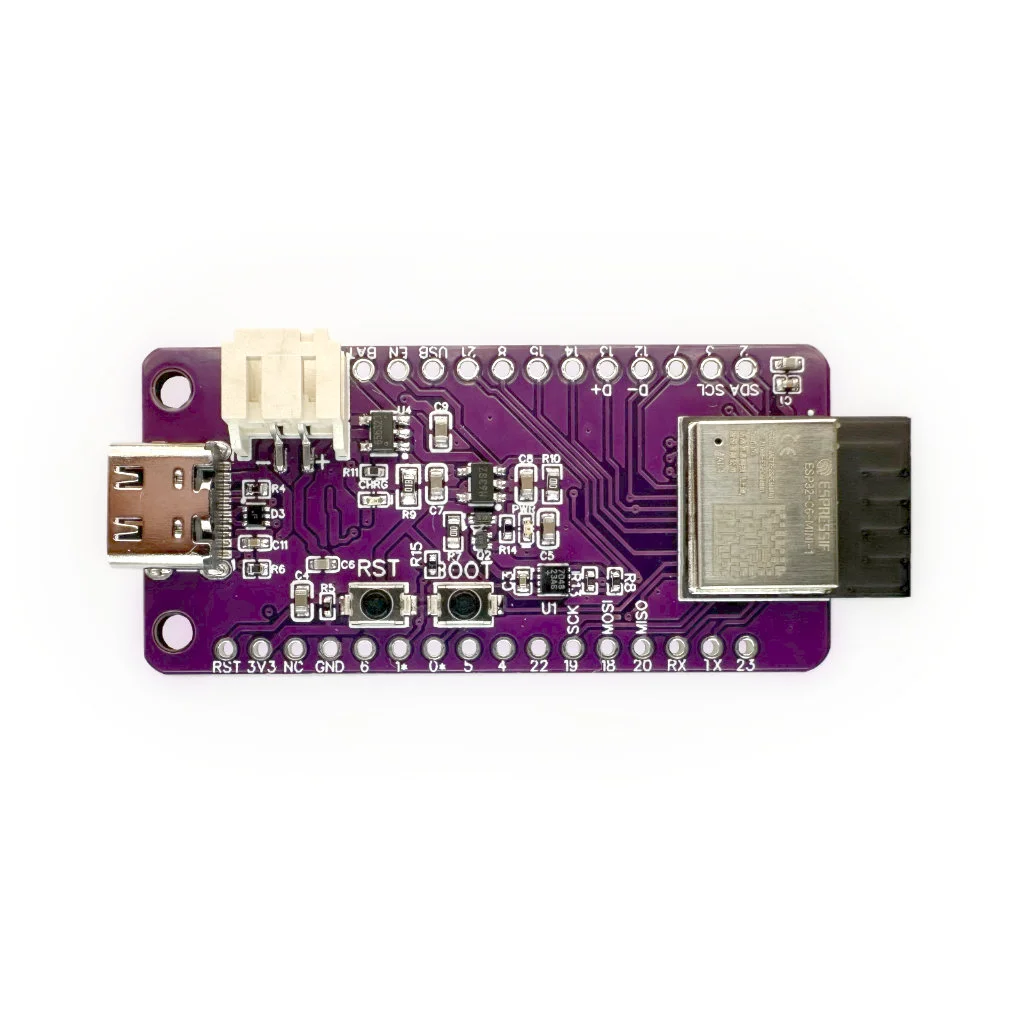

ThingPulse has recently released the ePulse Feather C6, an ESP32-C6-based development board with WiFi 6, BLE5, Zigbee, Thread, and Matter connectivity.
In my personal opinion, the “Feather” came from the Adafruit Feather as this board resembles the Adafruit form factor. Additionally, it features a battery connector with a TP4065 charging IC and MAX17048 fuel gauge IC.
This is the latest version of the ePulse Feather board that the company has released, as this board uses an ESP32-C6-MINI-1 module instead of an ESP32-WROVER-E-N8R8 module it can be directly programmed via the USB-C port and it doesn’t require a USB to UART converter.

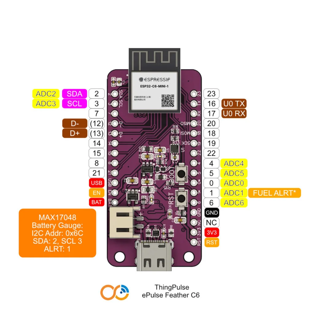

  • Expansion Options: Includes 12-pin and 16-pin headers, offering up to 17x GPIOs, 2x USB pins, and 1x fuel gauge pin.

The board doesn’t provide specific software; the board is programmable as a standard ESP32 C6 Dev Module using ESP-IDF or Arduino IDE. Its unique features are mainly hardware-based. Schematics, STEP files, and pinout diagrams are available on GitHub.
