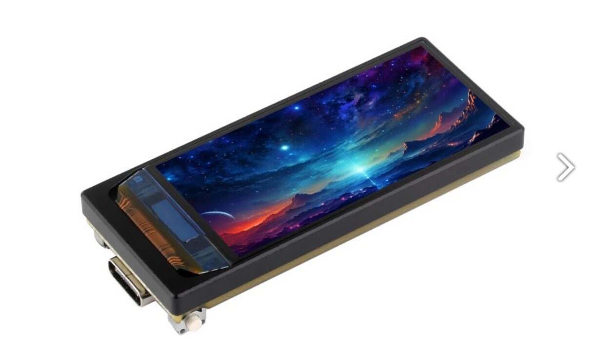

The ESP32-S3 1.91-inch AMOLED development board is designed for rapid prototyping of IoT and portable applications. Powered by the ESP32-S3R8 chip with a 240 MHz dual-core processor, it supports 2.4 GHz Wi-Fi and Bluetooth BLE 5, 16 MB Flash, and 8 MB PSRAM. Its capabilities are further enhanced by a 6-axis motion sensor, making it ideal for interactive and motion-responsive projects.
The board’s 1.91-inch AMOLED display boasts a 240×536 resolution with 16.7 million colors and is driven by the RM67162 controller via QSPI. Available in both touch and non-touch versions, the touch models use the FT3168 IC for precise input detection. Additional features include a QMI8658 6-axis IMU, a microSD card slot, and a Lithium battery header, providing flexibility for a wide range of applications.

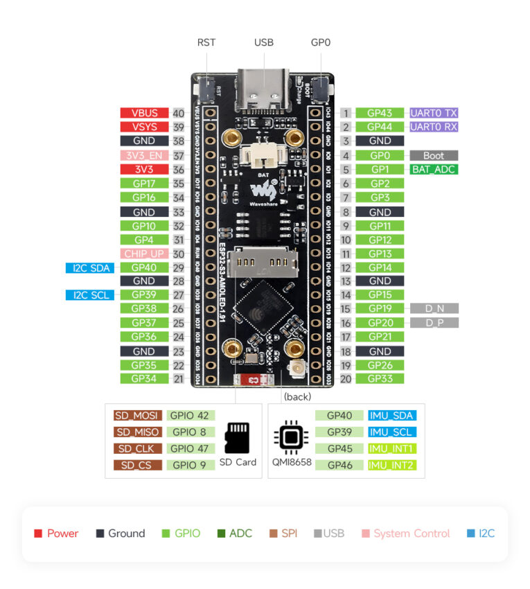

  • I/O Interfaces
    • USB Type-C port for power and programming
    • 2x 20-pin headers providing up to 27 GPIOs, 8 ADC channels, I2C, SPI, and display/touch interfaces
    • 5V, 3.3V, and GND pins
  • Sensors: QMI8658 6-axis IMU (3-axis accelerometer + 3-axis gyroscope) for motion detection, gesture recognition, and step counting

The ESP32-S3-AMOLED-1.91 board features a next-generation AMOLED display that delivers enhanced color accuracy, vivid visuals, and detailed picture quality. It supports development with ESP-IDF, Arduino IDE, and LVGL for efficient GUI design, making it ideal for HMI applications. The display is also compatible with Raspberry Pi Pico HATs. Schematics, setup guides, and demo code will soon be available on the company’s wiki.
