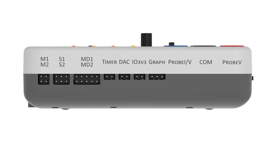

The new platform supports “plug and play” for some devices:
  • Directly plug up to 2 motors, max 1A/channel up to 30V .
  • Any 4 wire stepper motor, max 1A current rating.
  • Directly connect 2 relays, up to 30V.
  • Drive 2 servos adjustable voltage, up to 30V.
  • Port for 2 motor drivers.
evive_bottom
