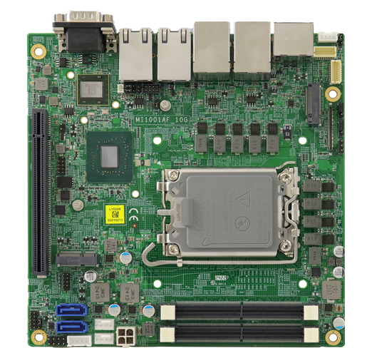

IBASE Technology Inc., a leading manufacturer of embedded systems and industrial motherboards, launches the MI1001 Mini-ITX motherboard, powered by 14th/13th/12th Gen Intel® Core™ DT processors (RPL-S Refresh Platform) with the Intel® Q670E chipset. This advanced motherboard supports up to 64GB of DDR5 memory and features integrated Xe graphics architecture that provides support for multiple displays, making it ideal for applications requiring high-quality video output and graphics performance. It offers exceptional performance for industrial and commercial applications, ensuring reliability and versatility for a variety of uses such as smart retail, automation, and IoT devices.
MI1001 FEATURES:
  • 14th/13th/12th Gen Intel® Core i9/i7/i5/i3 DT processors
  • 2x DDR5 SO-DIMM sockets, Max. 64GB
  • Intel processor integrated graphic supports eDP, LVDS and 1x DisplayPort (1.4a) (DP++), HDMI (2.0)
  • 2x Intel® 2.5G LAN & 2x Intel® 10G LAN
  • 4x USB 3.2, 2x USB 2.0, 2x COM, 2x SATA III
  • 1x PCI-E (x16) [Gen.5.0]; 2x M.2 (E-Key and M-Key)
  • Supports watchdog timer, Digital I/O, iAMT (16.1), TPM (2.0), +24V only DC input
The MI1001 comes in two distinct models: the MI1001AF-10G, which is equipped with dual 10GbE and dual 2.5GbE LAN ports, and the MI1001AF-Q, which features dual 2.5GbE LAN ports. The advanced LAN options in the MI1001AF-10G make it particularly suited for bandwidth-intensive applications. Both models include support for 4x USB 3.2, 2x USB 2.0, 2x SATA III, 2x COM ports, and 2x M.2 expansion slots (E-Key and M-Key). The M.2 M-key slot utilizes PCI-E (x4) lanes and supports NVMe SSDs, ensuring ultra-fast data transfer speeds for demanding applications. The board also features HDMI, DisplayPort, LVDS, and eDP interfaces.
Enhanced security features like TPM 2.0 and modern manageability, thanks to Intel’s iAMT (16.1) technology, make the MI1001 suitable for secure data transmission and remote management. These features are critical for secure data transmission and remote monitoring in industrial environments.
