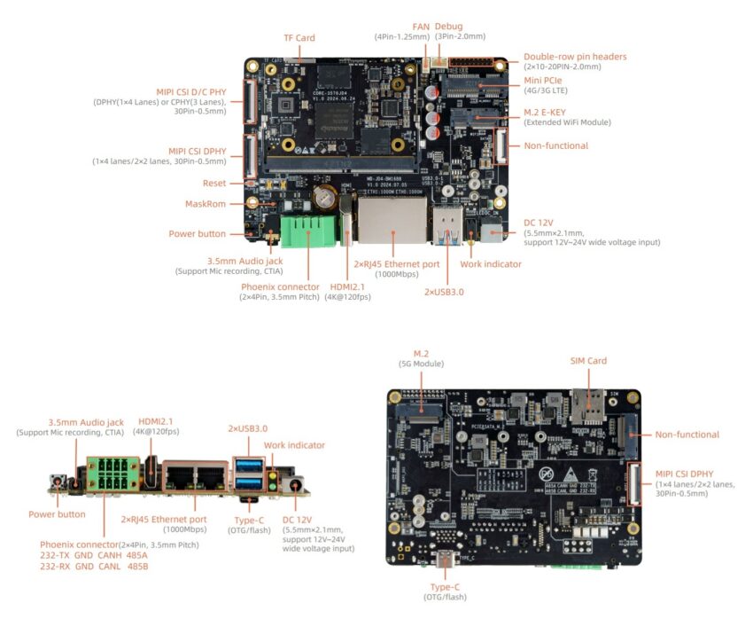

Designed for industrial applications, the AIO-3576JD4 includes an external watchdog for reliability and offers a wide range of expansion interfaces. These include MIPI-CSI, USB 3.0, USB 2.0, HDMI 2.1, Mini PCIe, M.2, Type-C, RS485, RS232, CAN, TF Card, and SIM Card, meeting diverse peripheral and application needs.
The Firefly AIO-3576JD4 board specifications:
    • SoC: Rockchip RK3576
      • CPU: Octa-core 64-bit processor (4×A72 + 4×A53), up to 2.2GHz
      • GPU: ARM Mali-G52 MC3 @ 1GHz
        • Supports OpenGL ES 1.1/2.0/3.2, OpenCL 2.0, Vulkan 1.1
        • Built-in high-performance 2D acceleration
      • NPU: 6 TOPS
        • Supports INT4/8/16/FP16/BF16/TF32 mixed operations
    • ISP: 16MP
      • Supports low-light noise reduction, RGB-IR sensor, up to 120dB HDR
      • AI-ISP for enhanced image quality and reduced noise
    • VPU:
      • Decoding: 4K@120fps (H.265/HEVC, VP9, AVS2, AV1), 4K@60fps (H.264/AVC)
      • Encoding: 4K@60fps (H.265/HEVC, H.264/AVC)
    • Memory: LPDDR4/LPDDR4x (4GB/8GB optional)
    • Storage:
      • eMMC (16GB/32GB/64GB/128GB/256GB optional), UFS 2.0 (optional)
      • 1x M.2 (SATA3.0/PCIe NVMe SSD, supports 2242/2260/2280)
    • Networking:
      • 2x RJ45 (1000Mbps) Ethernet
      • WiFi 6 and BT5.2 via M.2 E-Key (2230), 2.4GHz/5GHz dual-band
      • 4G LTE and 5G expansion via Mini PCIe and M.2 slots
    • Video Input:
      • 2x MIPI CSI DPHY (1x 4 lanes or 2x 2 lanes)
      • 1x MIPI CSI D/C PHY (MIPI DPHY or MIPI CPHY)
    • Video Output: 1x HDMI 2.1 (4K@120fps)
    • Audio: 1x 3.5mm Audio jack (MIC recording, CTIA standard)
    • USB:
      • 2x USB 3.0, 1x USB 2.0
      • 1x Type-C (USB 2.0/DEBUG)
    • Expansions:
      • 1x FAN header (4Pin)
      • 1x SIM card slot
      • 1x dual-row pin header (USB 2.0, SPI, I2C, Line In/Out, GPIO)
      • 1x Phoenix connector (RS485, RS232, CAN 2.0)
    • Power Supply: 12V DC input (12V~24V wide input voltage)
    • Dimensions: 122.89mm x 85.04mm x 22.7mm
    • Weight: ≈120g
    • Operating Temperature: -20°C to 60°C
    • Storage Humidity: 10% to 90%RH (non-condensing)

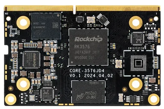

The AIO-3576JD4 mainboard is compatible with mainstream edge computing modules through its 260-pin standard SODIMM interface. This ensures flexibility in combining and replacing modules, meeting customization needs for various edge computing deployment scenarios. Supported core boards include the Core-1688JD4, Core-3576JD4, and Core-3588JD4, as well as NVIDIA Jetson Orin Nano and Jetson Orin NX modules.
Core-3576JD4 SODIMM
Core-3576JD4 SODIMM
