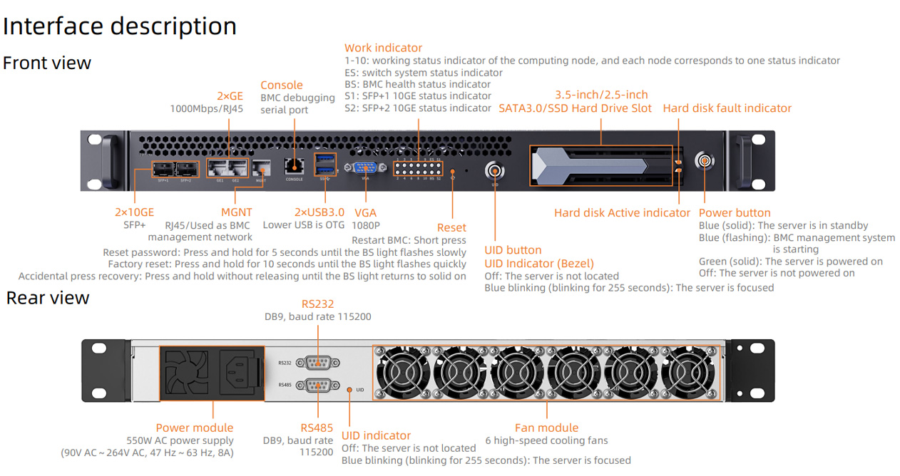

  • Networking:
    • CSB1-N10S1688: 2 × 10G Ethernet (SFP+), 2 × Gigabit Ethernet (RJ45)
    • CSB1-N10R3588/R3576: 2 × Gigabit Ethernet (RJ45), 1 × Gigabit Ethernet (RJ45, MGNT for BMC management)
  • Console Port: RJ45 console port
  • Display: VGA up to 1080p60
  • USB Ports: 2 × USB 3.0
  • Buttons: Reset, UID, power button
  • Miscellaneous:
    • 1 × RS232 (DB9, baud rate 115200)
    • 1 × RS485 (DB9, baud rate 115200)
  • Cooling: 6 high-speed fans
  • Power Supply: 550W (non-hot-swappable)
  • Operating Temperature: 0°C to 45°C
