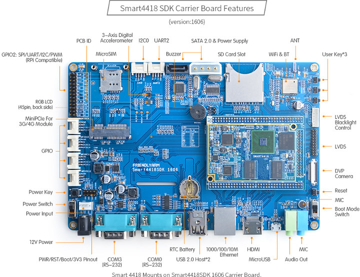

An SDK carrier board is available for the Smart6818 which enables the smart6818 CPU board’s various ports and interfaces. The carrier board has a SATA interface and a mini PCIe interface that supports an external 4G module. One incentive with this board is that it offers compatibility with the Raspberry Pi’s interface.
