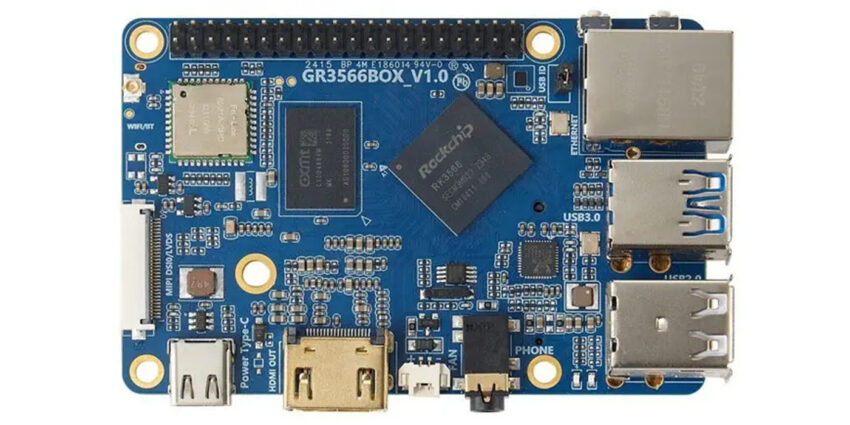

Graperain has recently launched the G3566 Single Board Computer (SBC), a compact and cost-effective computing solution powered by the Rockchip RK3566, a 64-bit quad-core Cortex-A55 processor clocked at 1.8GHz.
It has a Mali-G52 GPU and a 1T NPU for AI tasks, delivering high performance while keeping power consumption low. The board supports up to 8GB LPDDR4 RAM and various eMMC storage options (8GB to 128GB). It includes multiple connectivity options like Gigabit Ethernet, expandable WiFi 2.4/5GHz, Bluetooth 4.2, HDMI 2.0 (4K@60Hz), MIPI-DSI for displays, MIPI-CSI for cameras, USB 3.0 and USB 2.0 ports, M.2 for SSDs, and microSD card support. Built with an 8-layer immersion gold design, it ensures reliability and stability.
Rockchip RK3566 SBC
It supports multiple operating systems, including Android 12, Linux, Ubuntu, and Debian. The G3566 SBC is commonly used in handheld devices, industrial automation, networking, security systems, consumer electronics, medical equipment, digital signage, and education. It comes with a 5V/3A power adapter and includes resources like system-on-module (SOM) hardware schematics, source code, development tools, and manuals for customization and development.

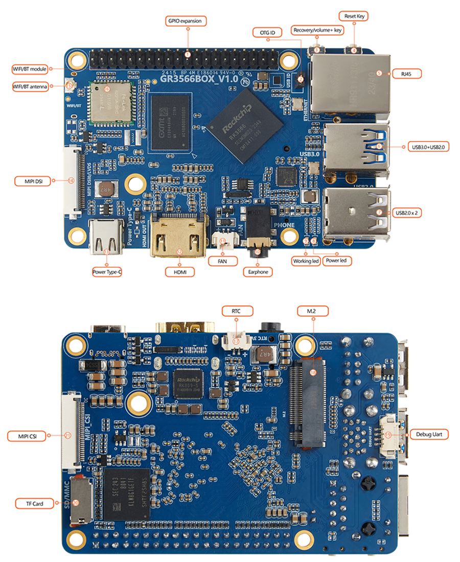

G3566 SBC Top and Bottom Peripherals
Rockchip RK3566 SBC Specifications:
  • SoC: Rockchip RK3566 quad-core Cortex-A55 processor @ 1.8GHz
  • NPU: 1 TOPS AI accelerator
  • GPU: Mali-G52 2EE GPU, supports OpenGL ES 1.1/2.0/3.2, OpenCL 2.0, Vulkan 1.1
  • Memory: 2GB/4GB/8GB LPDDR4/LPDDR4X
  • Storage:
    • 8GB/16GB/32GB/64GB/128GB eMMC (16GB default)
    • M.2 2242 slot for SSD
    • microSD card slot, supports up to 128GB
  • Video and Display:
    • 1x HDMI 2.0 up to 4K@60Hz
    • 1x MIPI DSI up to 1920×1080@60Hz
    • GPU-accelerated 4K video decoding (H.265, H.264, VP9)
    • 1080p video encoding (H.265 @ 100fps, H.264 @ 60fps)
  • Networking:
    • GMAC Gigabit Ethernet (1000Mbps)
    • Expandable WiFi and Bluetooth (via SDIO module)
      • Supports 2.4GHz/5GHz dual-band WiFi (802.11 a/b/g/n/ac)
      • Supports Bluetooth 4.2
  • Audio:
    • 1x 3.5mm audio jack with MIC recording
    • 1x HDMI audio output
  • Camera:
    • 1x MIPI-CSI (single channel, 4 lanes), supports up to 8MP camera
  • USB:
    • 1x USB3.0
    • 3x USB2.0
  • I/O:
    • 4x UART
    • 1x Debug UART
    • 1x I2C, 1x SPI, 1x I2S (2 channels)
    • 12x PWM, 1x ADC, 1x RTC
    • 1x FAN connector (5V)
  • Power Supply:
    • USB Type-C input (5V-12V)
  • Dimensions: 85mm x 56mm
  • Operating temperature: -20°C to 80°C
  • Storage temperature: -30°C to 80°C
  • Humidity: 10% – 80%
Additionally, the board supports H.265, H.264, and VP9 decoding and 1080p 100fps H.265 encoding for multimedia use. Its ARM G52 2EE GPU enhances graphics performance, supporting OpenGL ES 3.2, OpenCL 2.0, Vulkan 1.1, and a dedicated 2D engine.
