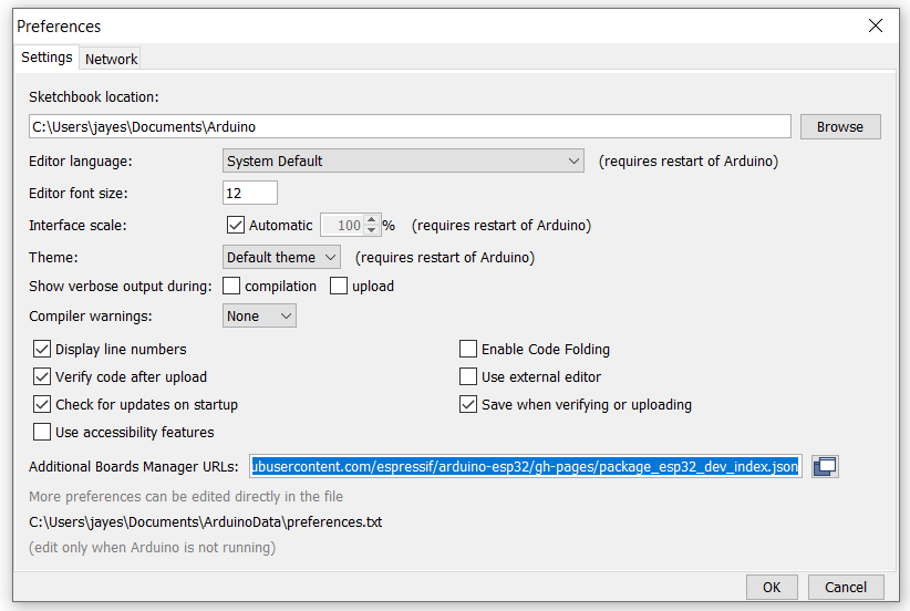

Step1: In your Arduino IDE window, go to File menu -> Preferences
Preferences Menu on Arduino IDE
Step2: Once the preferences menu is open, Enter https://raw.githubusercontent.com/espressif/arduino-esp32/gh-pages/package_esp32_dev_index.json in the Additional Boards Manager URLs field and hit OK.

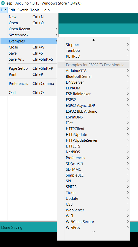

Now, under the File menu, in the examples section, you can see some inbuilt examples.

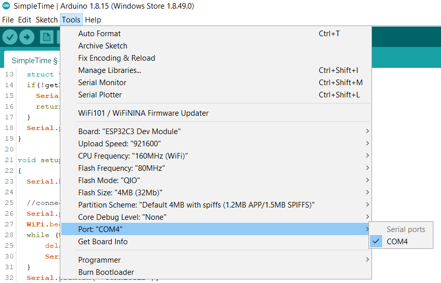

Port For the Development Board
Select a proper port for your board with preferred settings. The port number of the board can be found using Device Manager on your PC.
Port COM4 for ESP32-C3-DevKITM-1

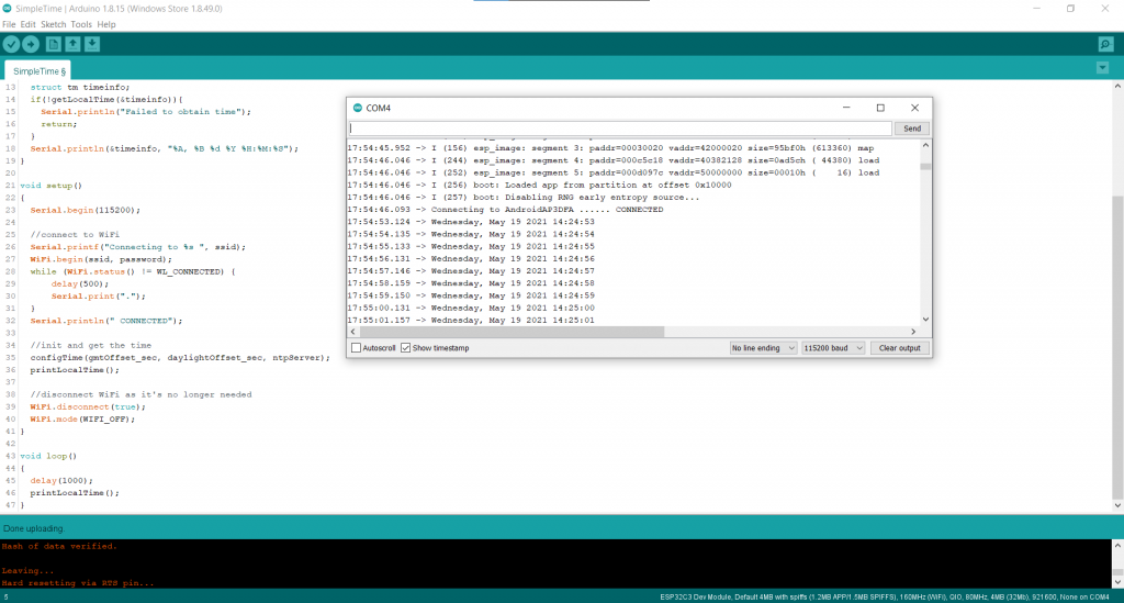

Here, we executed an ESP32-> Time-> SimpleTime example which connects your board to a WiFi network to obtain and display the current date and time on the serial monitor. Enter your network’s SSID and password in the code. Just compile the sketch and then upload it to the board. Also, open the Arduino IDE’s Serial Monitor at a baud rate of 115200 to view the result.
Serial Monitor of ESP32-C3-DevKITM-1
Before uploading, put the ESP32C3 board in programming mode by long-pressing the boot button and simultaneously pressing the reset button once, and then releasing the boot button.
