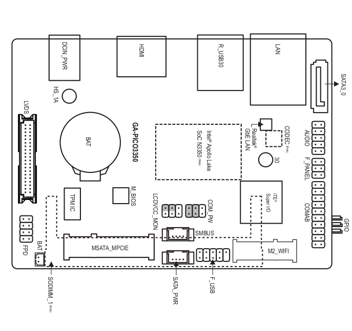

GIGABYTE GA-PICO3350 may be the smallest motherboard from the company so far. The Pico-ITX board comes with an Intel Celeron N3350 dual-core Apollo Lake processor with a SO-DIMM slot, SATA port, and mSATA socket that give you more options will selecting RAM and storage.
GA-PICO3350 specifications:
  • SoC – Intel Celeron N3350 dual-core Apollo Lake processor @ up to 2.4 GHz with 2 MB cache, Intel HD graphics; 6W TDP
  • System Memory –  1 x DDR3L SO-DIMM socket supporting up to 8 GB DDR3L 1866/1600 MHz
  • Storage- 1x SATA 6Gb/s connector,  1x mSATA connector (multiplexed with mPCIe), 128 Mbit flash for BIOS/UEFI
  • Video Output
    • HDMI 1.4 up to 3840×2160 @ 30 Hz
    • 1x LVDS header
    • 1x flat panel display header
  • Audio – Realtek ALC887 codec, 1x front panel audio header
  • Connectivity – Gigabit Ethernet port via Realtek PHY
  • USB – 2x USB 3.0/2.0 ports on the back panel, 2x USB 2.0/1.1 ports available through the internal USB headers
  • Expansion
    • 1x M.2 Socket  connector for the wireless communication module (M2_WIFI)
    • 1x full-size Mini PCIe slot (MSATA_MPCIE)
    • 1x GPIO header
    • 1x SMBUS
    • 1x serial port header
  • Misc – Front panel header,  serial port power select jumper (COM_PW), LCDVCC/MON header (LCDVCC_MON),  battery cable header, iTE I/O controller chip, HW/monitor with voltage & temperature detection
  • Power Supply -12V DC
  • Dimensions – 10 x 7.2 cm (Pico-ITX form factor)
