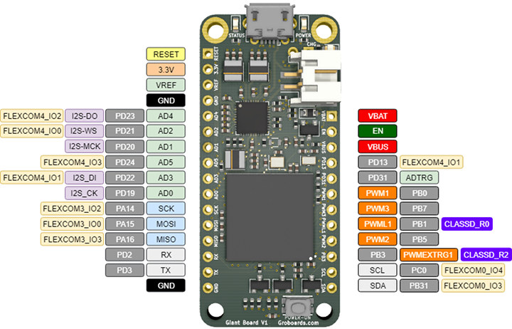

Giant Board Pinout

  • Other I/O – Micro-USB port, 6x 12-bit ADC with 3.3V reference, 4x 16-bit PWM, ADC and PWM external triggers, I2C, SPI, UART
  • Power — 3.3V pin input; “full” 3.7V LIPO support
