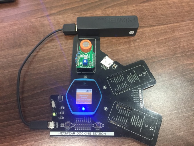

Knowing the amount of alcohol you drunk is becoming easier using the iBreathe Breathalyzer project by Dave Clarke. You just have to blow in the alcohol sensor, then it pings the result to a smartphone app and to the cloud to document it as a table so you can see alcohol intake through time.
This breathalyzer with a custom Beer mug casing will let you know where do you stand on the scale form “Sober as a judge” to “Hangover incoming”!
Below the (foamy) surface, it has substance too: along the 3D-printed casing, it features an Alcohol click sensor hacked to work with 3.3V, a customized Hexiwear interface, and a smartphone app.

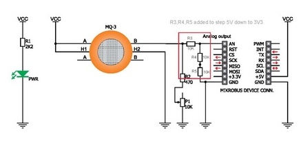

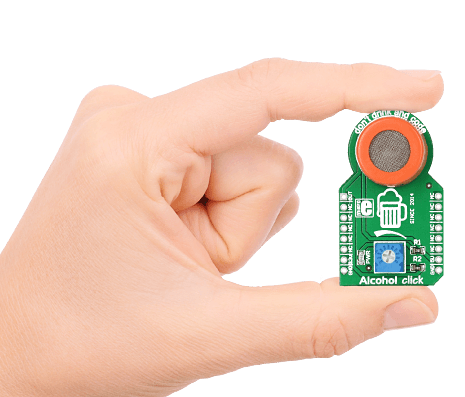

Alcohol click carries an MQ-3 Semiconductor sensor for alcohol. The gas sensing layer on the sensor unit is made of Tin dioxide (SnO2), an inorganic compound which has lower conductivity in clean air. The conductivity increases as the levels of alcohol gas rise. Alcohol click has a high sensitivity to alcohol and it can be used to detect alcohol in concentrations from 0.04 to 4mg/l. To calibrate the sensor for the environment you’ll be using it in, Alcohol click has a small potentiometer that allows you to adjust the Load Resistance of the sensor circuit. Alcohol click communicates with the target board through AN (OUT) mikroBUS line. It’s designed to use a 5V power supply only. While Hexiwear’s analog input is 3.3V, this sensor was hacked by adding a voltage divider on the output pin of the Click Board.
