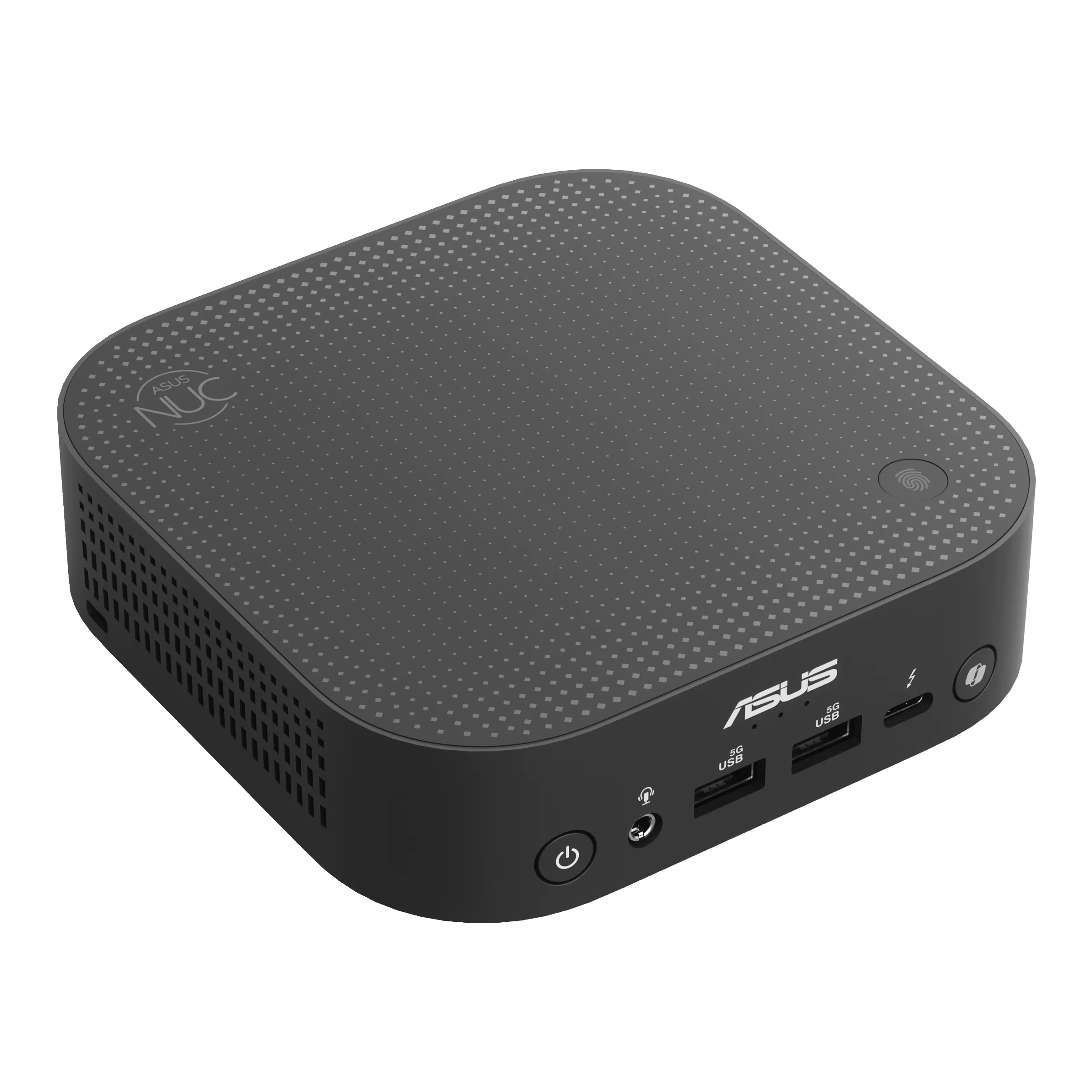

The ASUS NUC 14 Pro AI is a compact, high-performance mini PC powered by Intel Core Ultra processors, designed for consumer, commercial, and edge computing applications. It features advanced AI capabilities with a neural processing unit delivering up to 48 TOPS, and Intel Arc GPU providing an additional 67 AI TOPS, significantly boosting AI inferencing and performance. It supports LPDDR5x memory for high bandwidth and includes various connectivity options such as Wi-Fi 7, Bluetooth 5.4, 2.5GbE Ethernet, USB 3.2, Thunderbolt 4, and HDMI. The device also has a robust cooling system and security features like TPM and fingerprint recognition. Measuring just 130 x 130 x 34 mm, it is compact but powerful and suitable for AI processing, edge computing, and multimedia tasks.
Previously we have written about various AI mini-PCs including ASUS Chromebox 5a, the Mekotronics R57, the AAEON de next-TGU8-EZBOX, and many more feel free to check those out if you are interested in compact AI-powered mini PCs.
The most interesting features of this ASUS NUC 14 Pro AI are its AI capabilities, a neural processing unit that delivers 48 TOPS, and the Arc GPU, delivering up to 67 AI TOPS. Additionally, the Intel XMX AI engine accelerates AI inferencing tasks by up to 16 times compared to traditional GPUs.
