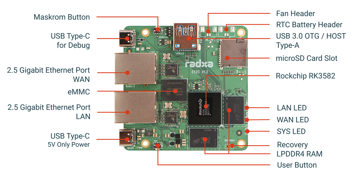

Radxa E52C Enhanced Mini Network Router Specifications:
  • SoC: RK3582
    • Processor:
      • Dual Cortex-A76 cores
      • Quad Cortex-A55 cores
    • Powerful performance for high-intensity tasks and low power consumption for daily use
    • NPU: 5 TOPS AI acceleration
  • Multimedia: H.265 / H.264 multivideo encoder up to 4K@60fps
  • Memory:
    • 2GB, 4GB, and 8GB LPDDR4
  • Storage:
    • 16GB, 32GB, and 64GB eMMC flash
    • 1x MicroSD card slot
  • Network Connectivity:
    • Dual 2.5G Ethernet ports via Realtek RTL8125BG, for stable and high-speed networking
  • USB Ports:
    • 1x USB 3.0 Type-A port / HOST support for expanded connectivity
    • 1x USB Type-C port for serial console access / Debug
  • Misc:
    • 1x User button
    • 1x Maskrom pinhole
    • 1x WAN
    • LAN
    • LED Status indicator
  • Power:
    • 5V DC via USB Type-C port
    • 3A via USB 3.0 Type-A port (while connecting peripherals
  • Dimensions:
    • 72 x 72 x 28.7 mm (with Aluminum alloy enclosure)
    • 70 mm x 70 mm (without enclosure)
  • Operation Temperature: 0 ~ 50°C
  • Certification: FCC, CE
E52C mini network router Interfaces
Radxa E52C is designed with a user-friendly interface that simplifies configuration and enables easy setup as a USB NAS. A library for hardware access and control on Linux is also provided by Radxa. However, as of now, the product page’s download section only includes resources like a product brief, schematics (PDF), a components placement map, and 2D drawings, with no software files available yet.
