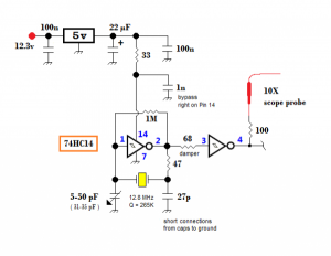

Vasily Ivanenko build some discrete chip oscillators with 74HC series logic gates and tests them on his oscilloscope. He writes: In numerous RF synthesizer chips lies an inverter with input and output pins for making a reference crystal oscillator clock. I built some discrete chip inverter xtal... Read More
