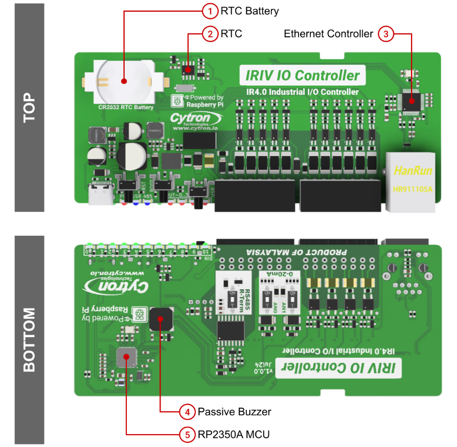

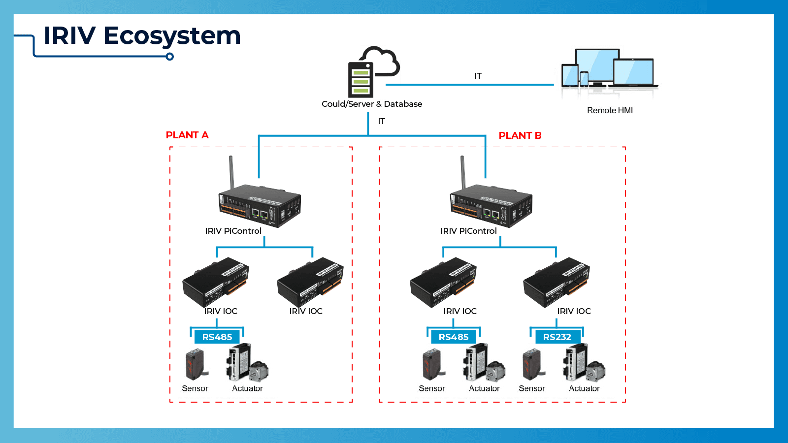

Cytron has recently released the IRIV RP2350 IO Controller, an industry 4.0 controller built around the Raspberry Pi RP2350 microcontroller. The USP of the product is that it comes with a variety of isolated interfaces such as DI and DO up to 50V, an ethernet port powered by the W5500, and features a DIN rail mount for industrial environments. Additionally, it includes various interfaces like ADC, RS232, RS485, and many other generic interfaces that are accessible through the front IO block.
Previously we have written about various DIN rail IO controllers and industrial controllers like the AAEON  BOXER-6711-ADN, the Arduino Edge Control Arduino, the Axiomtek iNA600 controller and much more feel free to check those out if you are interested in the topics.

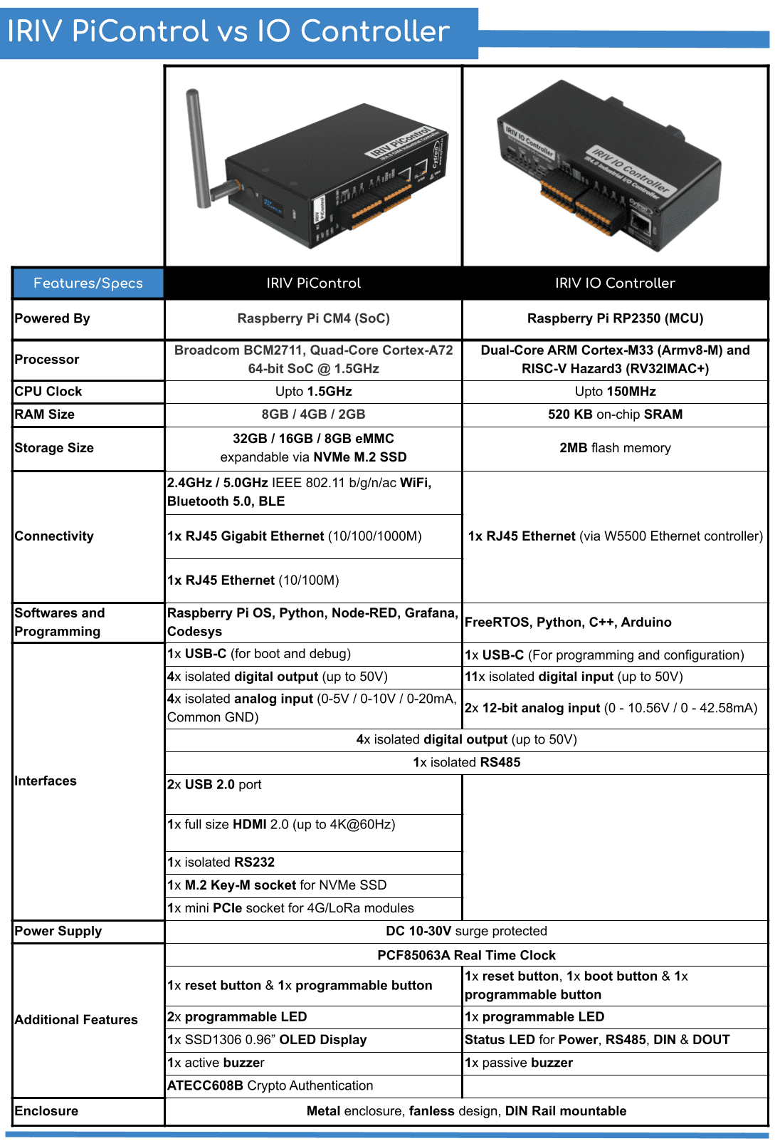

Just Last Year the company released the Cytron IRIV PiControl industrial controller which was built around the Raspberry Pi CM4 module, but the new IRIV IO controller is a much more affordable piece of equipment with a reduced feature set. The detailed comparison table between the Raspberry Pi CM4 and Raspberry Pi RP2350 industrial controllers is given below.

  • Powered By: Raspberry Pi RP2350 (MCU)
  • Processor: Dual-Core ARM Cortex-M33 (Armv8-M) and RISC-V Hazard3 (RV32IMAC+)
  • CPU Clock: Up to 150MHz
  • RAM Size: 520 KB on-chip SRAM
  • Storage Size: 2MB flash memory

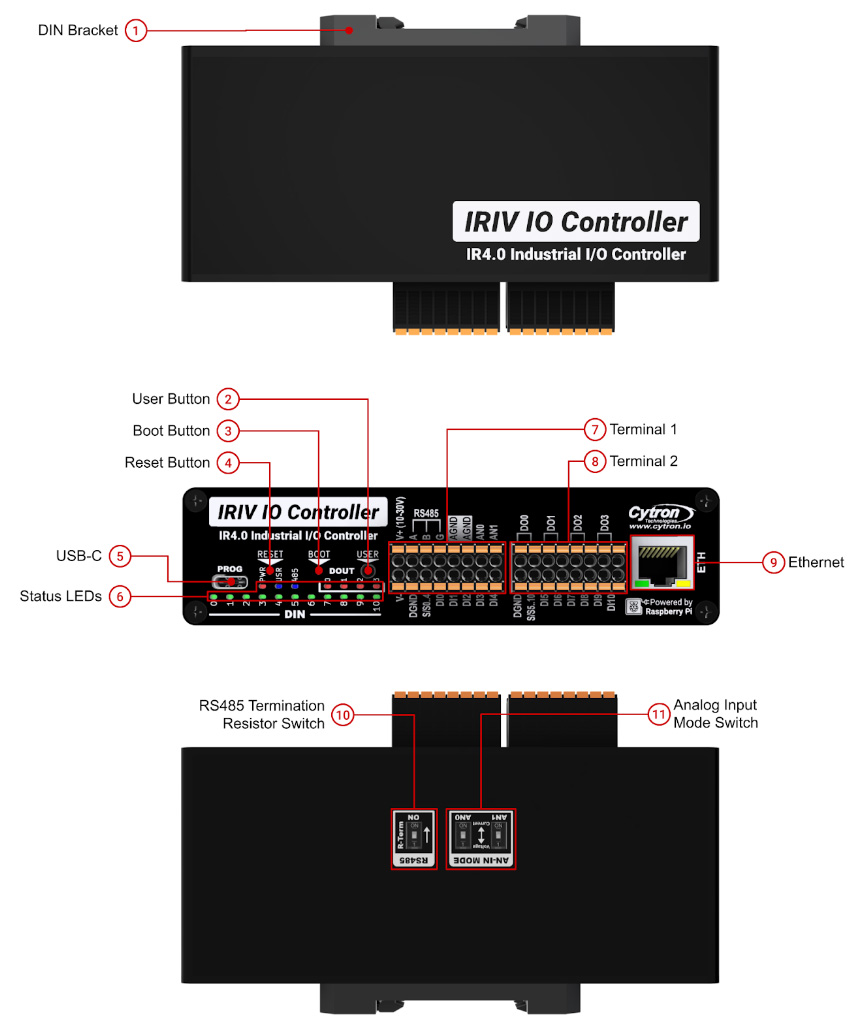

  • Connectivity: 1x RJ45 Ethernet (via W5500 Ethernet controller)
  • Interfaces:
    • 1x USB-C (For programming and configuration)
    • 11x isolated digital input (up to 50V)
    • 2x 12-bit analog input (0-10.56V/0-42.58mA)
    • 4x isolated digital output (up to 50V)
    • 1x isolated RS485
  • Power Supply: DC 10-30V surge-protected
  • Additional Features:
    • PCF85063A Real Time Clock
    • 1x reset button, 1x boot button & 1x programmable button
    • 1x programmable LED
    • Status LED for Power, RS485, DIN & DOUT
    • 1x passive buzzer
  • Enclosure: Metal enclosure, fanless design, DIN Rail mountable
