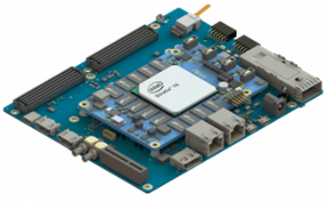

iWave Systems unveils the first look of Intel® Stratix® 10 powered System on Module at embedded world 2022. The System on Module is compatible with the SX and GX series of Stratix 10 SoC and FPGA, and is available in a form factor of 110mm x 75mm.
Stratix 10 brings about a revolutionary Intel® Hyperflex™ FPGA Architecture delivering the embedded performance, adaptability, power efficiency, density, and system integration essential for a broad range of high-performance embedded applications. Featuring a hard processor system (HPS) with an integrated 64-bit quad-core ARM Cortex-A53 processor with a feature-rich set of peripherals such as a system memory management unit, external memory controllers, and high-speed communication interfaces.
The Stratix® 10 Stems on Module provides for up to 2.7 million logic elements in a monolithic die, up to 48 transceivers deliver 4X serial bandwidth over the previous generation, Hard floating-point DSP enables single-precision operations up to 9.2 TFLOPS. The System on Module is compatible with GX850 to GX2800 and SX850 to SX2800 with a form factor of 110mm x 75mm.
