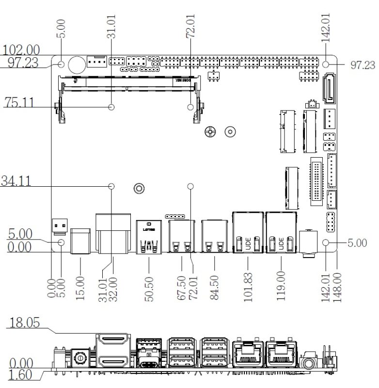

Jetway has launched a new 3.5-inch board named Jetway F35-ADN1, featuring the Intel N97 processor. It supports up to 32GB DDR5 memory, has options for HDMI and DP for display, and includes dual Ethernet ports for network connections. The board is certified with CE/FCC Class A certifications, making it an optimal choice for applications in industrial robotics, payment systems, and machine vision.
Previously we covered many powerful SBCs like the AAEON GENE-EHL7, iBASE IB961, Banana Pi BPI-M7, Hummingbird 8P Edge Ai and many other SBCs feel free to check those out if you are interested in the topic.
The Jetway JF35-ADN1 includes two 2.5GbE ports, eight USB 2.0 ports, two USB 3.2 Gen 2 ports, supports up to 32GB DDR5 RAM, and can power three displays with two HDMI 2.0b and one DisplayPort over USB-C.

  • Dimension (L x W): 148mm x 102mm (5.8″ x 4″)

The board is designed for Automated Guided Vehicles (AGV) and is adaptable for uses like machine vision and payment systems. It’s an entry-level solution for industrial robotics, compared to the more advanced UP Xtreme 7100.
The Jetway F35-ADN1 single-board computer (SBC) is now available and being mass-produced. For more information, including documentation and software drivers, visit the product page.
