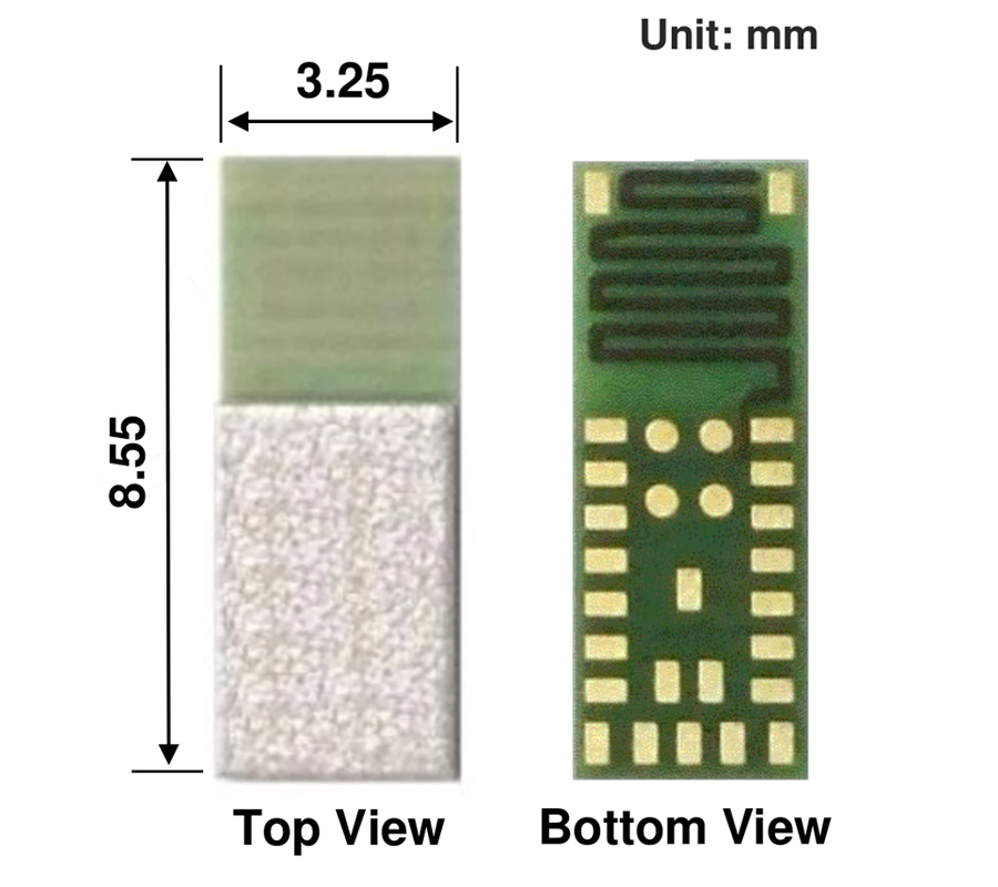

Kaga FIE has recently announced the ES4L15BA1, a Low-Power BLE wireless module that’s currently under development, designed to offer high-performance connectivity with Bluetooth 6.0, supporting data rates of 2M, 1M, 500k, and 125kbps, as well as advanced features like Angle of Arrival (AoA), Angle of Departure (AoD), and channel sounding. Operating within the 2402–2480 MHz frequency range and a typical output power of +8 dBm, it runs on a single power supply (1.7–3.6V). It has an ARM Cortex M33 processor featuring TrustZone security, with 1.5MB of non-volatile memory and 256KB RAM. This compact module (3.25 x 8.55 x 1.00 mm) integrates an advanced antenna, and system clock, and includes peripherals like a global RTC, 14-bit ADC, and a RISC-V coprocessor for customizable software-defined peripherals.

  • Dimensions: 8.55 x 3.25 x 1.00 mm
