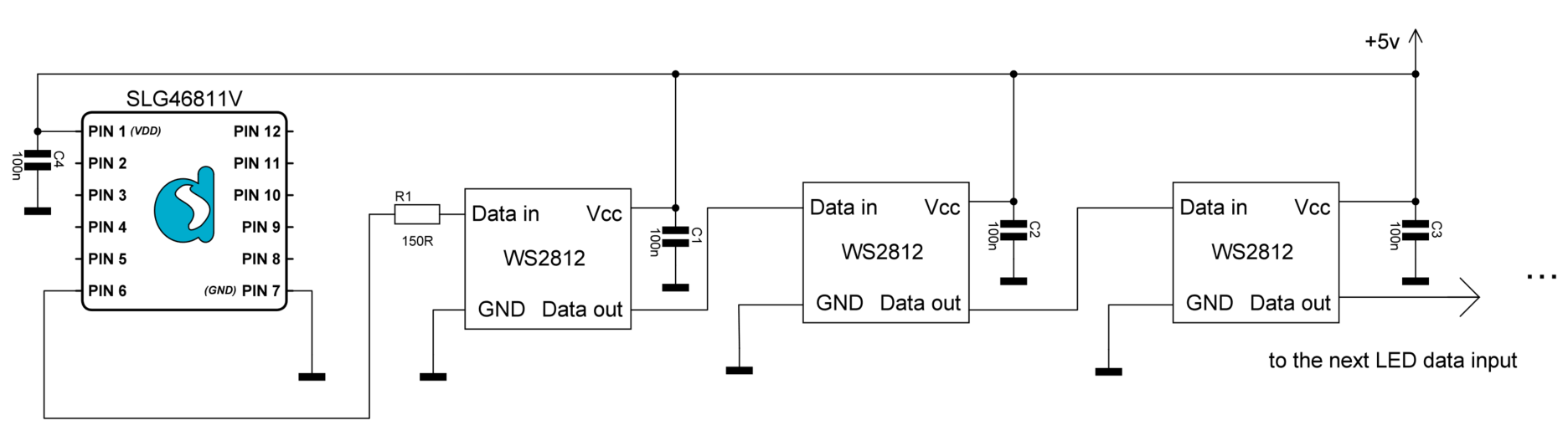

1.3 Proposed Electrical Connection
A signal pin should never have a higher voltage than Vcc. It is recommended to connect a resistor from data out pin 6 of the SLG46811 to an LED data input pin.
It is also recommended to connect all the LED Vcc pins and the SLG46811 Vcc pin in parallel to preserve this condition. A small capacitor (100 nF) is required across each LED Vcc-GND pin (see Figure 4).

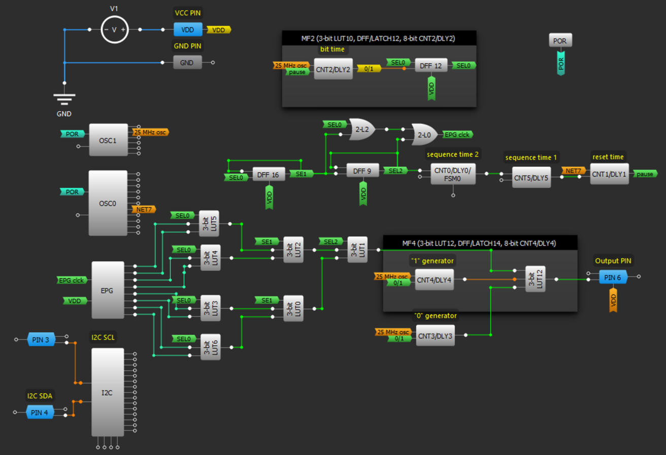

The simplified GreenPAK™ configuration scheme is shown in Figure 5.

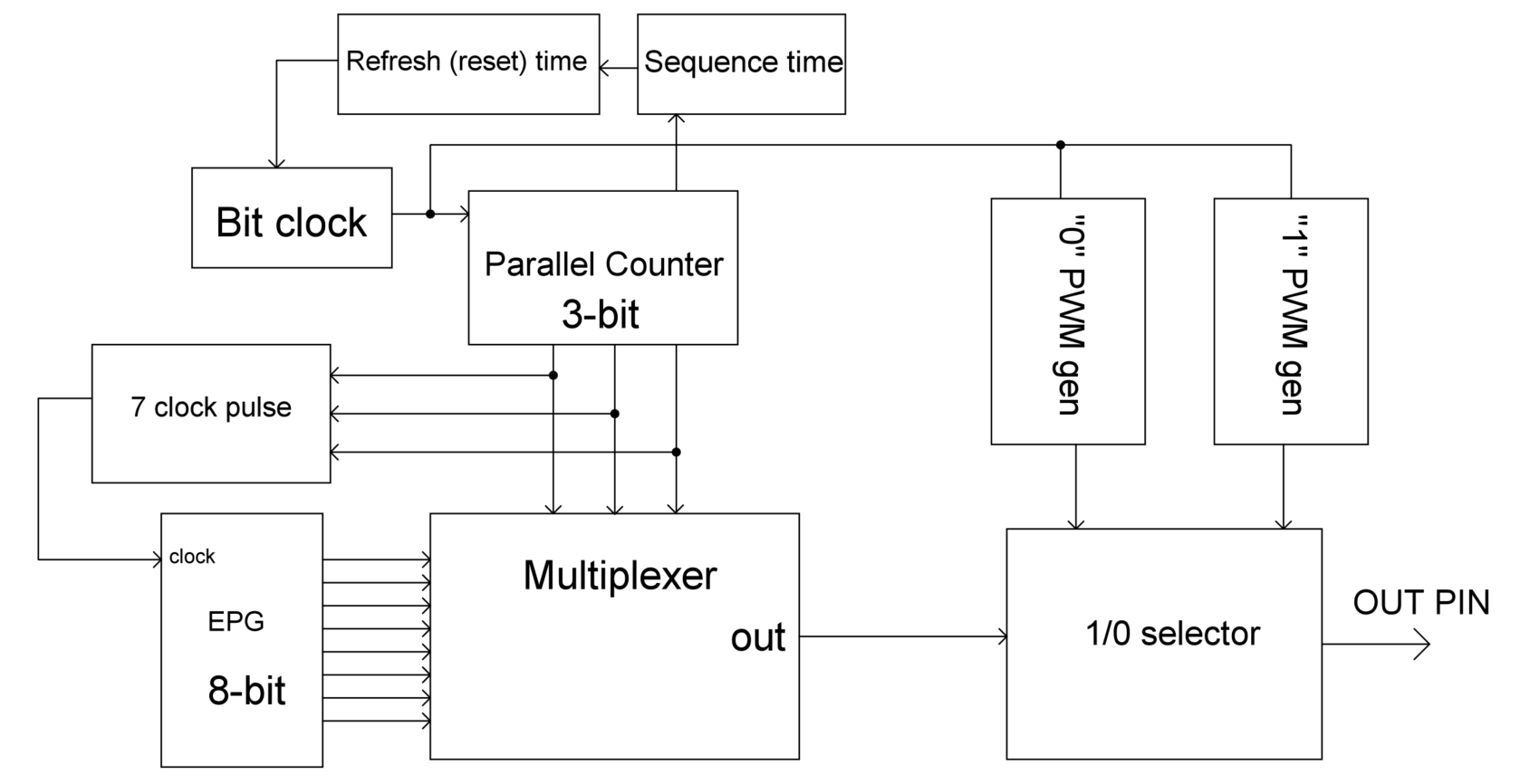

The simplified design structure of the SLG46811 pattern generator as configured by GreenPAK Designer is shown in Figure 6.

2. Internal Block Configuration

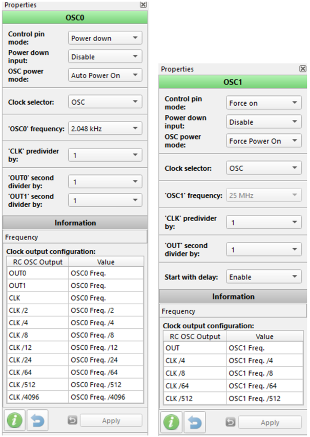

The proposed pattern generator is based on the SLG46811 IC. The internal oscillators OSC0 and OSC1 are configured to output 2.048kHz/8=256Hz and 25MHz respectively (see Figure 7).
![](https://www.electronics-lab.com/wp-content/uploads/2021/12/7.png)
2.1″Zero and One” Code Generator
To form a PWM with a fixed high-level time, the 8-bit CNT3 and CNT4 counter blocks are configured for 280ns and 880ns high-level period time. CNT2 is used to form a total of 1.24us one-shot time. DFF12, DFF16, and DFF9 count to 8 bits forming a byte impulse. CNT0 and CNT5 together count up to 279 bytes, which fills all the LEDs with information bits from the EPG plus an extra 3 bytes to create a shift effect. For example, 92 bytes from the EPG are sent three times in a row (92*3=279 bytes) including 3 bytes extra to make the shift effect. Each LED takes 3 bytes from a bitstream, thus 93 LEDs can be addressed. CNT1 generates a reset pause for latching all the transmitted bytes into LEDs and represents a limit of display refresh rate (which limits the visual velocity of a string movement). CNT1’s 15ms delay time will result in 66 frames per second.

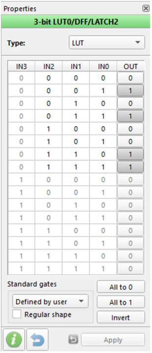

The 3-bit LUT0-LUT6 form a multiplexer, which transforms a byte from the EPG to serial bits for output.
All multiplexer LUTs have the same configuration setting shown in Figure 8.
![](https://www.electronics-lab.com/wp-content/uploads/2021/12/8.png)

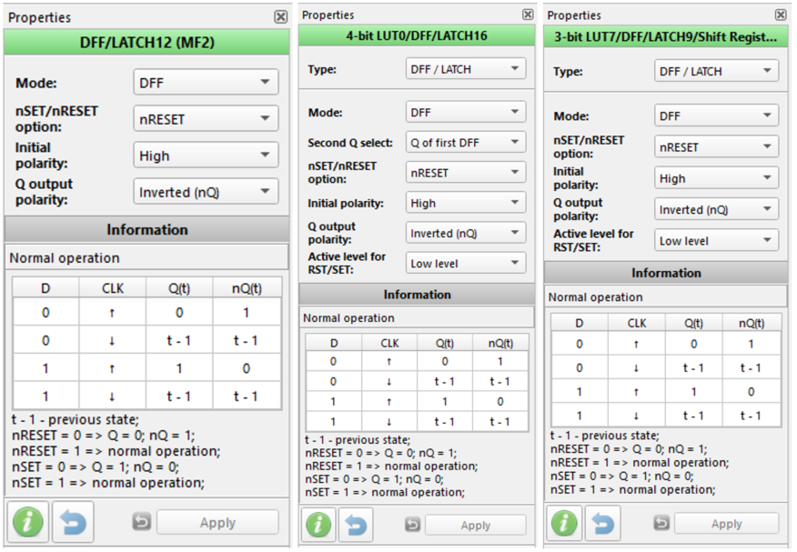

DFF9, DFF16, and DFF12 form a 3-bit parallel counter, which addresses the multiplexer. The address is reset every byte pulse through reset inputs. The DFFs are all configured as a D flip-flop with inverted output, as shown in Figure 9.
![](https://www.electronics-lab.com/wp-content/uploads/2021/12/9.png)

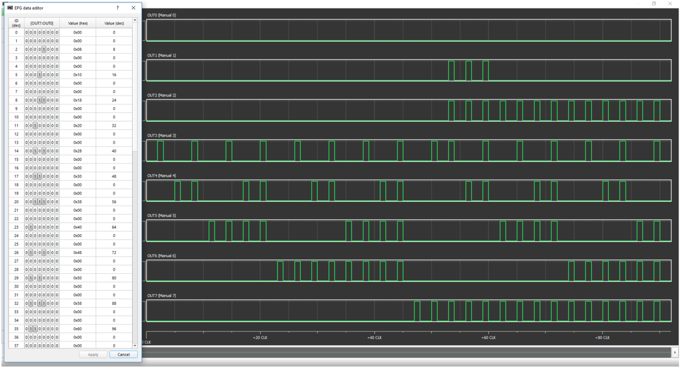

The extended pattern generator (EPG) is configured for an overflow action: after all 92 bytes are clocked out, the generator is reset to byte 0 (see Figure 11). In this design we are addressing 61 LEDs, so we are clocking the EPG two times in a row. It would be ideal to address 92 LEDs to clock the EPG 3 times. In this case, CNT0 should be configured for 276 clocks (3*92) plus 3 bytes for a shift (running string effect), thus reaching 279 in total. Entering the sequence into the EPG, users should keep in mind that 90 bytes from the generator would address 30 LEDs and the 91-92 bytes will go to the 31st LED only for green and red color bytes. The next “overflowed” first byte from the EPG will go to the blue byte of the 31st LED. So the 31st LED will have a shift of 1 byte compared to the first run of the EPG. We have to program a sequence into the EPG to make a color shift.
The programmed EPG bytes are: (0,0,8,0,0,16,0,0,24,0,0,32,0,0,40,0,0,48,0,0,56,0,0,64,0,0,72,0,0,80,0,0,88,0,0,96,0,0,104,0,0,112,0,0,128,0,0,136,0,0,142,0,0,150,0,0,158,0,0,164,0,0,172,0,0,180,0,0,188,0,0,196,0,0,204,0,0,212,0,0,220,0,0,228,0,0,236,0,0)

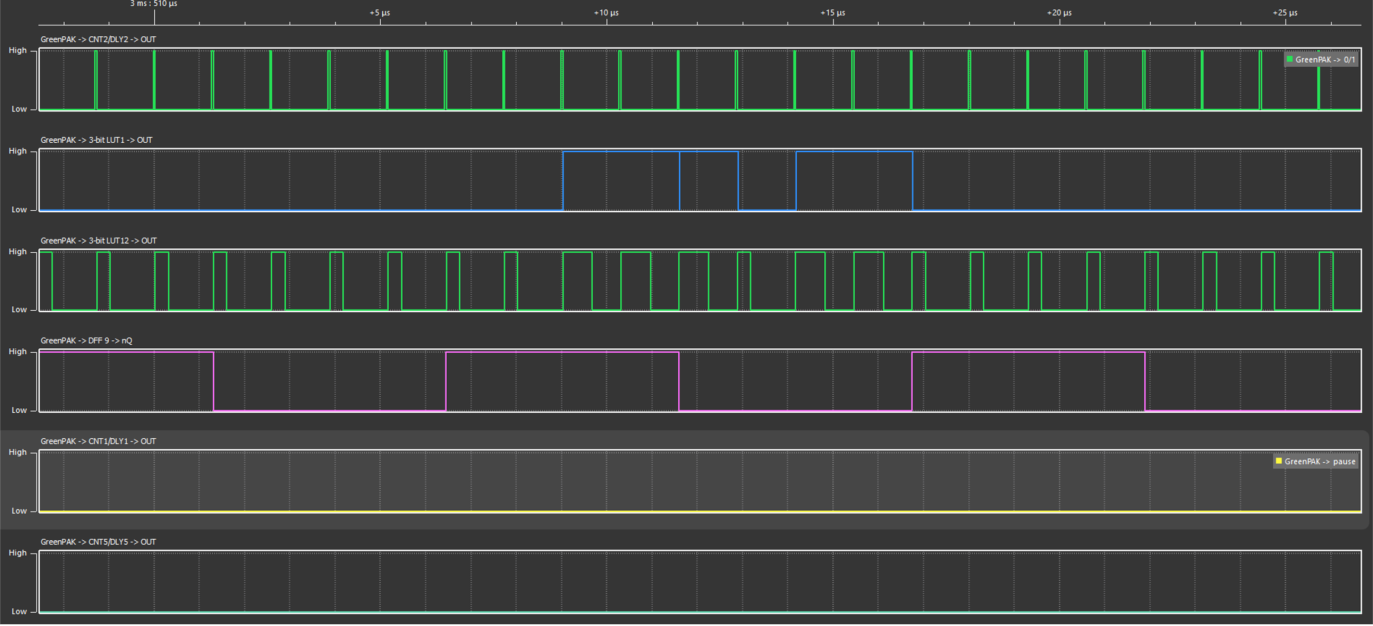

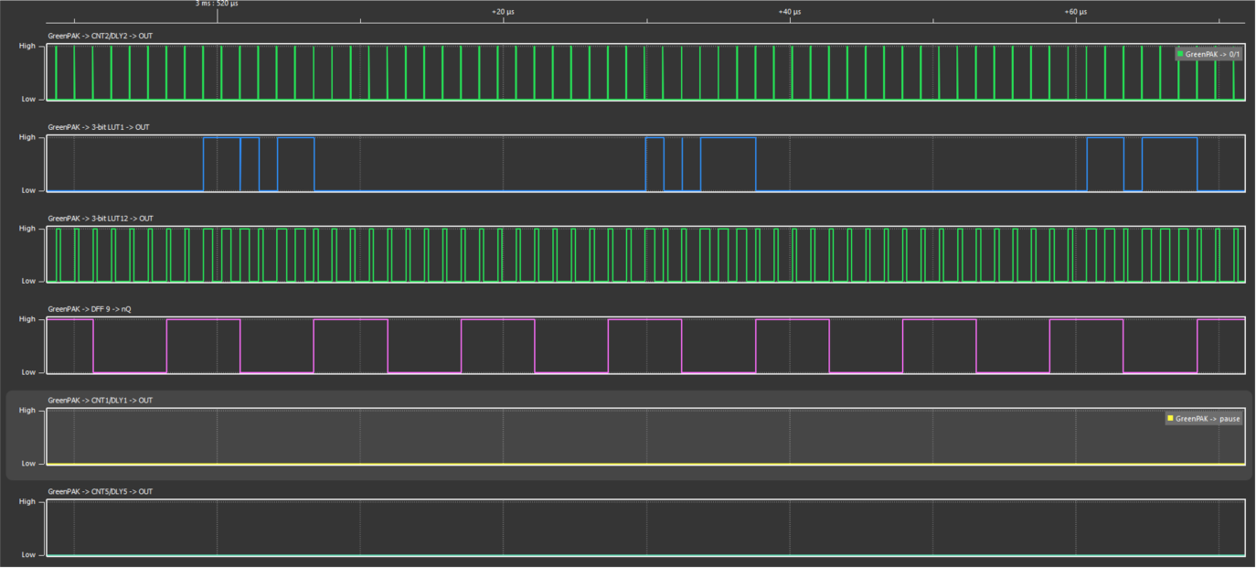

After tuning the timings and programming the EPG with the desired sequence, the SLG46811 is ready for operation. Its timing diagram is shown in Figure 13.
The oscilloscope waveform is shown in Figure 14.

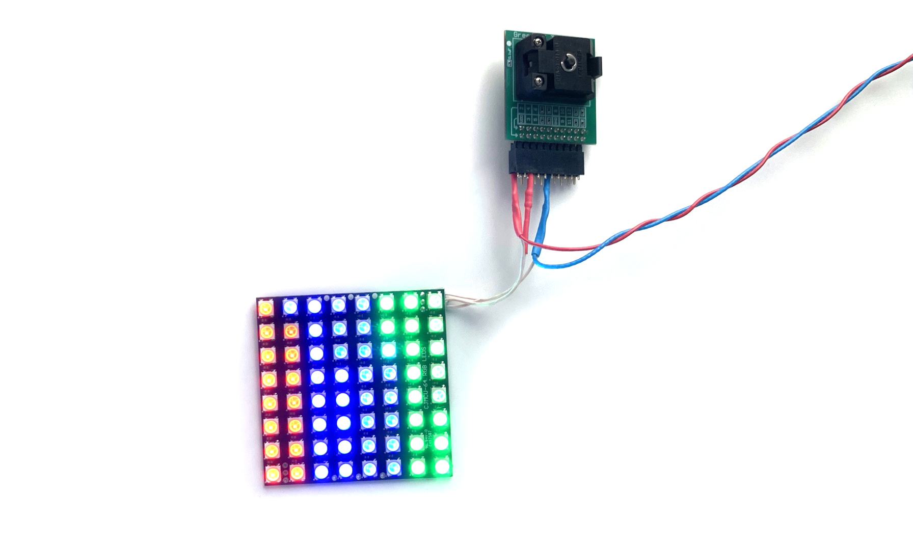

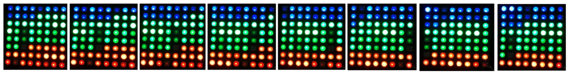

The working prototype series of photos is shown in Figure 15.

Conclusion
The proposed pattern generator using the SLG46811 in conjunction with a chain of WS2812B LEDs can deliver a “running string” of colors for a decorative visual effect.
