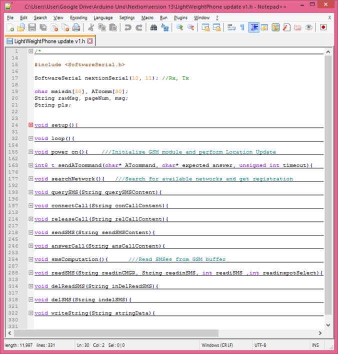

Program The Arduino
The Arduino is the brain of this project. It takes input from the Nextion display, sends commands to GSM module to create the cellular connection, and shows information on the display. This project does not use any Nextion library due to lack of documentations and difficulties to understand. Moving on without using libraries seems tough but it is really not.
The code can be found on the Github repository. Simply download it and upload to the Arduino board using the Arduino IDE. If you are using some other board than Arduino UNO, then don’t forget to select that specific board in Arduino IDE before uploading.
![Editing the Arduino sketch](https://www.electronics-lab.com/wp-content/uploads/2017/06/codes.jpg)

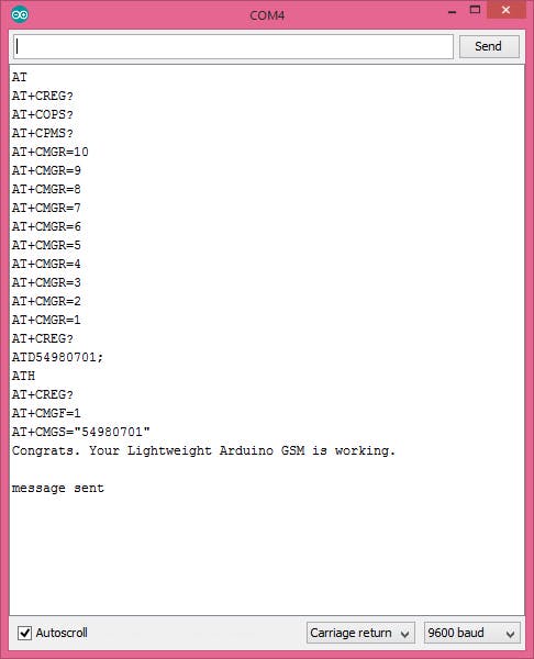

Open the Serial Monitor, you should see the AT command log for each event triggered from the Nextion Display.
![Serial Monitor shows the AT command log](https://www.electronics-lab.com/wp-content/uploads/2017/06/logs.jpg)

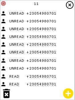

Important Note
By default, the GSM module has an SMS buffer size of 20. Unfortunately, this Arduino-based mobile cannot display all the 20 messages at once on the Nextion display as it gives a buffer overflow while compiling the Nextion code. Hence, the Nextion display is programmed to show maximum 10 messages at once. If 10 or more SMS are present on the GSM buffer, the Low memory warning icon will be displayed on the Nextion display.
![SMS log showing received messages on Nextion display](https://www.electronics-lab.com/wp-content/uploads/2017/06/bonus.jpg)
