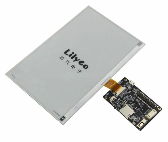

LilyGO is now offering up to a 7.5-inch screen display that works well with most of their T5 boards. So we can now have an ESP32 board connected with a 7.5-inch e-paper display.
LilyGO did not disclose much information on the 7.5-inch e-display but we were able to gather some facts.
The $52 7.5-inch e-paper weighs 44 grams and has a resolution of 800 x 480 pixels, a wide viewing angle and clear display, ultra-low power consumption, and communication via SPI interface. It is Arduino-programmable and backward compatible with the previous T5 E-paper solutions.

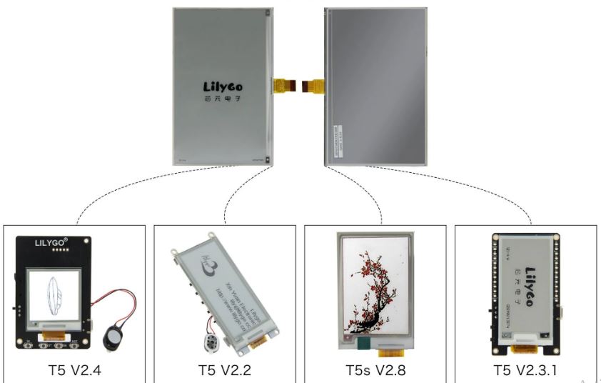

The 7.5-inch electronic ink screen supports T5 development motherboards with 1.54, 2.13, 2.6, 2.7, 2.9, or 3.7 inches displays, but it is not compatible with the T5-4.7-inch board. It is perfect for applications such as shelf labels and industrial instruments.
The 7.5 inch electronic paper display currently goes for $52, but if you are getting it with the T5 2.4.1 board, you will pay an additional $7, totaling $59.
