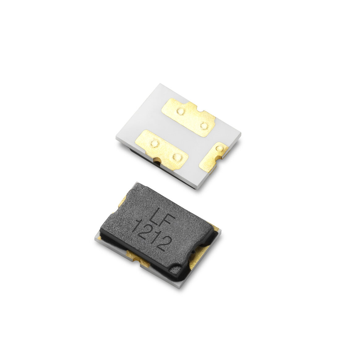

Littelfuse, Inc., an industrial technology manufacturing company empowering a sustainable, connected, and safer world, announced the new ITV4030, a series of 22 amp, three-terminal, surface-mountable Li-ion battery protectors.
These 4.0 x 3.0 mm devices protect battery packs against overcurrent and overcharging (overvoltage) conditions. The innovative design uses embedded fuse and heater elements that provide fast response and reliable performance to interrupt the charging or discharging circuit before the battery pack becomes overcharged or overheated.

  • Surface mountable design simplifies automated PC board assembly processes.
  • Certifications from UL and TUV aid in securing approvals with meeting industry compliance requirements.
  • The environmentally friendly component is halogen-free and RoHS compliant.
How it works
An embedded three-terminal fuse cuts off the circuit when overcurrent issues occur. A heater element, directly embedded under the fuse element, generates enough heat to blow the fuse once overcharging is detected by IC or FET.
