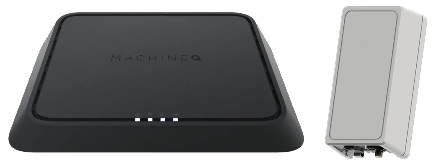

The current clamp is LoRa-powered, so it should be open to all and you can connect to any gateway, right?  However, the company does not mention anything about it and by the looks of it, you need to buy their propitiatory gateway and services to get this clap to work as it’s designed to work.
MachineQ Area-8c and Field 16C Outdoor LoRa Gateway
The company provides multiple gateway options for indoor and outdoor conditions. for indoor conditions, they have MachineQ Area 8c, an 8-channel indoor LoRaWAN gateway designed to handle up to 10,000 devices. For outdoor conditions, you have MachineQ Field 16c which is a a rugged, outdoor LoRaWAN gateway designed for localized IoT deployments. It has an operating temperature range of -40°C to +60°C with IP67 protection. So it’s built for harsh environments.

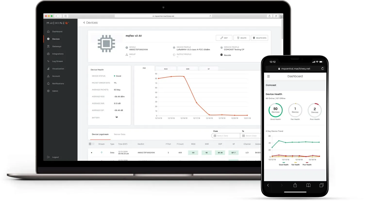

The gateways are designed to handle thousands of devices simultaneously, so to manage it all the company has its network management tool for connecting and managing all the devices together.
