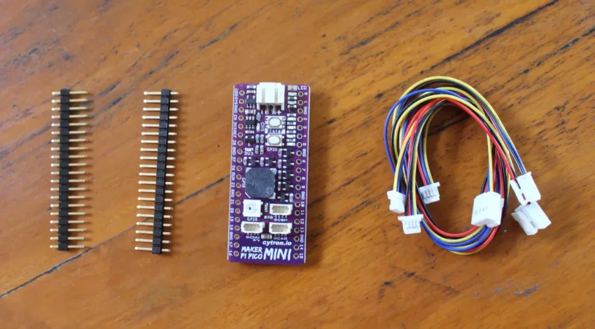

Cytron Technologies, a Malaysian company that specializes in designing boards and modules that help to simplify digital-making processes for makers and developers, has designed a Maker Pi PICO Mini Board aimed at simplifying projects with the Raspberry Pi Pico / Pico W.
Nicknamed “Small but Mighty”, the Maker Pi Pico Mini is designed for portability and can be powered by a LiPo connector, rechargeable via a USB port, and with an over-charge/over-discharge protection circuit. It is just like the $12 Maker Pi Pico board, just that it comes in a much more compact form and can fit into any project.
The Mini board is powered by the Raspberry Pi Pico/Pico W and comes equipped with plenty of useful features such as GPIO status LEDs, WS2812B Neopixel RGB LED, a passive piezo buzzer, a reset, and a user-programmable button.
The board is so small that Cytron said it had to ditch the Grove connectors and replace them with three maker ports for expansion.
“Utilizing the JST-SH 4-way connector, Maker port is compatible with Sparkfun’s Qwiic modules and Adafruit’s STEMMA QT modules,” Cytron explains. “Qwiic and STEMMA QT are using I2C communications and can be daisy-chained. By using the included JST-ST to Grove conversion cables, Maker port is compatible with SeeedStudio’s Grove modules too. Besides I2C, Maker Port also supports UART, Analog input and Digital Input/Output.”
