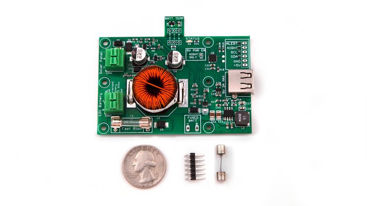

makerPower Solar is a combination intelligent solar battery charger and power supply for low- to medium-power devices freeing them from the outlet. It is designed to provide 24/7 power for a wide range of embedded systems and IoT gadgets.
According to Julio:
Optimal charging is provided through a dynamic perturb-and-observe maximum power-point transfer converter (MPPT) and a 3-stage (BULK, ABSORPTION, FLOAT) charging algorithm.
The makerPower Solar offers 12V operation using 25W to 35W (12V) solar panels, along with 7Ah to 18Ah AGM lead-acid batteries. It has 35W MPPT charging, charge temperature compensation (via temp sensor), 10W/5V power supply available through a USB Type-C port, low-battery shutdown/restart capability, and a digital interface (via I2C).
Features & Specifications
  • 12 V Operation
    • Uses commonly available and inexpensive 25-35 W 12 V solar panels and 7-18 Ah sealed AGM lead-acid batteries (UPS batteries).
    • Lead-acid batteries are ideal for outdoor solar applications because they are lower cost that other battery technologies, operate over a wider temperature range and are safe.
  • 35 W Maximum Power-Point Charging
    • Implements a MPPT algorithm to operate the solar panel at the point of maximum power generation to extract every bit of energy the panel is capable of producing. More efficient that PWM-style chargers and much more efficient than just attaching the panel to the battery.
    • Three-state charger for fast and safe battery charging (BULK, ABSORPTION, FLOAT).
  • Charge Temperature Compensation
    • Temperature sensor monitors battery temperature and adjusts charge parameters to optimally charge the battery while protecting it from life-shortening overcharge conditions.
  • 10 W 5 V Power Supply
    • Available from USB Type A socket for plug&play with many devices or from a 0.1” header for direct connection.
    • Capable of powering a Linux SBC and long-distance radio like a cellular modem or SatComm module.
  • Low Battery Shutdown and Restart
    • Five-volt output disabled when the battery is almost discharged with automatic restart when the battery is recharged.
    • Alert signal available to provide warning of impending power-off for controlled shutdown. Use it to protect the filesystem in Raspberry Pi applications.
  • Digital Interface
    • I²C interface provides full access to charger measurements, state and configuration values.
    • Status signals allow direct control for simple systems.
  • Night-Only Mode
    • Automatically enable the system only at night.
  • Watchdog
    • Ensure system reliability by power cycling when the attached system crashes or hangs.

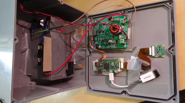

This Remote webcam project is powered by the makerPower and features a Raspberry Pi Zero, Pi camera, and motion sensor to snap pictures of wildlife.
