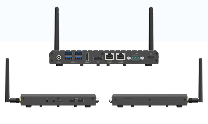

The MS-1P17 Ultra Slim Fanless Box PC MSI is powered by Intel Alder Lake-N processors, providing an ultra-low-power solution ideal for industrial applications. It supports up to 16GB of DDR5 4800 MHz memory via a SO-DIMM slot and offers dual independent display outputs through DisplayPort and HDMI. Its slim, fanless 25mm design makes it suitable for space-constrained installations.
The system is equipped with two 2.5 GbE LAN ports for fast, reliable networking, and offers expansion options through one M.2 B Key and one M.2 E Key slot. Connectivity features include 4 USB 3.1 ports, 2 USB 2.0 ports, RS-485 communication, audio, and two reserved antenna slots. It operates on a 12-24V DC input, designed to meet the demands of various industrial environments.

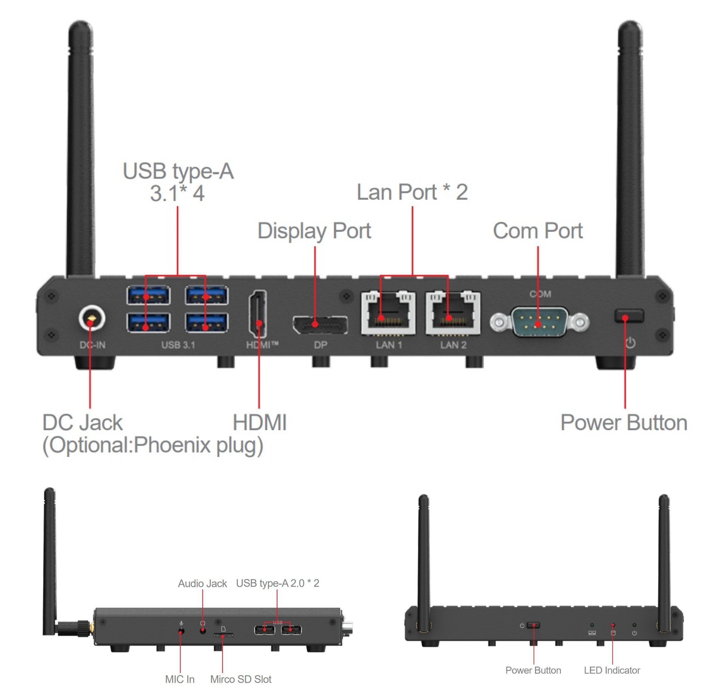

The MSI MS-1P17 specifications:
  • Processor
    • Intel IOTG Alder Lake-N N97 Processor up to 3.6 GHz, 6MB cache, AMI BIOS, TDP: 12W
    • Intel IOTG Alder Lake-N Atom X7425E processor up to 3.4 GHz, 6MB cache, AMI BIOS, TDP: 12W
    • Intel IOTG Alder Lake-N Core i3-N305 processor up to 3.8 GHz, 6MB cache, AMI BIOS, TDP: 15W
  • GPU: Intel UHD Graphics
  • Memory: Up to 16GB single-channel DDR5 4800 MHz
  • Storage
    • 1x 262-pin SO-DIMM socket
    • 1x MicroSD card slot
  • Video:
    • 1x HDMI up to 3840 x 2160 @30Hz
    • 1x DP up to 4096 × 2304 @60Hz
    • 2 independent displays support
  • Audio
    • Codec: Realtek ALC256 HD Audio
    • 3.5mm audio jack
    • 1x Mic-in
  • Connectivity: 2x Intel I225-V 2.5 GbE LAN
  • USB
    • 4x USB 3.1 Type-A
    • 2x USB 2.0 Type-A
  • Serial: 1 x COM port (COM1: RS-232/422/485)
  • Expansion
    • 1 x M.2 B key 2242/3042/2280
    • 1 x M.2 E key 2230
  • Antenna: 2 SMA connectors reserved for antennas
  • Misc:
    • 256-level Watchdog Timer
    • Infineon SLB9672VU2.0 TPM for N97 and Atom X7425E processor
    • 3x LED indicators
    • Power button
  • Power supply: 12~24V DC-in with Lockable DC Jack
  • Temperature range
    • Operating: 0~40 °C
    • Storage: -20 ~ 80°C
  • Humidity
    • Operating: 10 ~ 90%, non-condensing
    • Storage: 10 ~ 90%, non-condensing
  • Certificate
    • EMC: CE, FCC, RCM, VCCI, BSMI, UKCA
    • Safety: BSMI
  • Dimension and weight: 197 x 162.8 x 25 mm | 0.91 kg
The key difference between the models is that the Core i3 variant lacks the Infineon SLB9672VU2.0 TPM controller, while other variants include it. The platform supports multiple operating systems, including Windows 10 IoT Enterprise 2021 LTSC (64-bit, 21H2), Windows 11 IoT Enterprise (64-bit, 22H2, Pre-scan), and Linux upon request.
Video
The system offers flexible mounting options with both stand and VESA mount configurations, suitable for various installation needs. The included stand is made of ABS+PC material and measures 199.8 x 64 x 28 mm, providing a durable and compact solution for supporting the device.
MSI has not disclosed pricing details. For more information, please refer to the product page.
