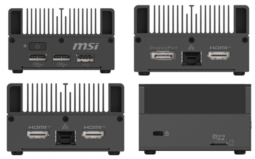

MS-C918S ports

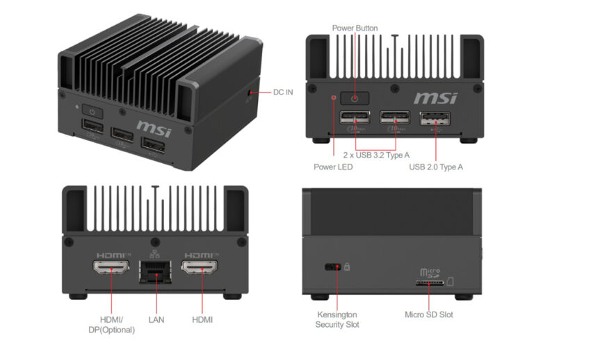

MS-C918S points
The MS-C918S supports VESA mounting for flexible installation options and is compatible with Windows 11 23H2, offering smooth operation with the latest OS features.
