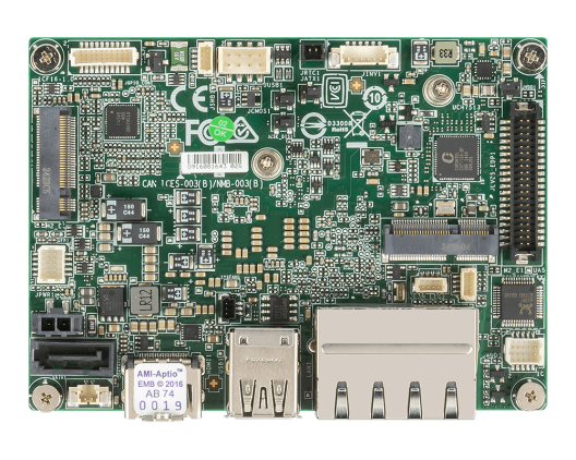

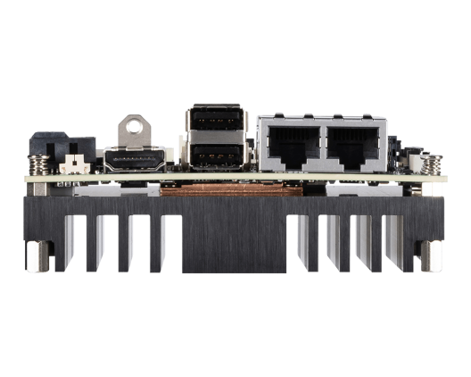

The MS-CF16 Fanless SBC, manufactured by MSI, is a compact, fanless, low-power Pico-ITX Single Board Computer(SBC) designed for high-performance applications in challenging environments. It provides options for Intel Alder Lake-N or Amston Lake Series SoCs and comes with 2.5GbE and GbE LAN ports, SATA 3.0 storage, and dual independent display outputs. Additionally, the board comes with a range of I/O options, including USB, serial COM, GPIO, and audio, making it suitable for applications where the pace is limited.

MS-CF16 Fanless SBC Specifications
  • Processor
    • Alder Lake-N SKUs
      • Intel IOTG Alder Lake-N Processor N97, QC, 12W (up to 3.6 GHz, 6MB Cache) or
      • Intel IOTG Alder Lake-N Atom x7425E, QC, 12W (up to 3.4 GHz, 6MB Cache)
      • Integrated Intel UHD Graphics
    • Amston Lake SKUs
      • Intel® IOTG Amston Lake Atom, X7433RE, QC, 9W (up to 3.4 GHz, 6MB Cache)
  • Memory
    • Single-channel LPDDR5 4800 MHz (Up to 16GB)
  • Storage
    • 1x SATA 3.0
    • 1x M.2 E key 2230 (PCIe x1 + USB 2.0)
    • 1x M.2 B key 2242/3042 (PCIe x1/SATA 3.0 + USB 3.2 Gen 2 + USB 2.0)
  • Display
    • 1x HDMI (up to 3840 x 2160 @30Hz)
    • 1x LVDS/eDP (up to 1920 x 1200 @60Hz)
    • 2 independent displays
  • Audio
    • Realtek ALC897 High Definition Audio Codec
  • Networking
    • Alder Lake-N SKUs
      • 1x Realtek RTL8125BG-CG 2.5GbE LAN
      • 1x Realtek RTL8111K-CG 1GbE LAN
    • Amston Lake SKUs
      • 1x Realtek RTL8125BI-CG 2.5GbE LAN
      • 1x Realtek RTL8111KI-CG 1GbE LAN
  • USB
    • 2x USB 3.2 ports (rear)
    • 2x USB 2.0 ports (internal)
  • Other I/O
    • 1x COM port (internal, RS-232/422/485)
    • 8-bits GPIO (4 x GPI; 4 x GPO), 5V
  • TPM
    • Infineon® SLB 9672VU2.0 (Alder Lake-N) or Infineon® SLB 9672XU2.0 (Amston Lake)
  • Other Features
    • 256-level Watchdog Timer
  • Power Supply
    • 12V DC input
  • Dimensions
    • 101 x 73 mm (Pico-ITX form factor)
  • Weight
    • 0.30 kg
  • Operating Temperature
    • -10° to 60° C (Alder Lake-N SKUs)
    • -40° to 70° C (Amston Lake SKUs)
  • Certifications
    • CE, FCC Class B, BSMI, VCCI, RCM, UKCA, IC
