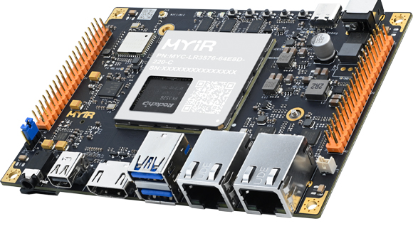

The MYC-LR3576 System-On-Module (SOM), with its compact size of 43mm x 45mm, delivers exceptional reliability for your upcoming embedded design projects. Powered by the robust Rockchip RK3576 application processor, it boasts a quad-core Cortex-A72 and a quad-core Cortex-A53, an integrated 6 TOPS NPU, and a 3D GPU. The RK3576 supports various video codecs, including up to 8K@30fps or 4K@120fps decoding (H.265/VP9/AVS2/AV1) and up to 4K@60fps encoding (H.265/H.264), ensuring users can experience high-quality video playback and recording. In addition to the RK3576 CPU, the MYC-LR3576 SOM integrates 4GB/8GB LPDDR4X and 32GB/64GB eMMC on board. It provides a range of peripherals and IO signals via a 381-pin expansion interface with an LGA package. It also supports Linux and Debian OS. With its high-performance and low-power design, this feature-packed SOM is suitable for scenarios such as industrial, AIoT, edge computing, smart mobile terminals, and many other digital multimedia applications.
Highlights:
  • Rockchip RK3576 Octa-core Arm Processor with Quad Cortex-A72 Cores at 2.2 GHz and Quad Cortex-A53 Cores at 1.8 GHz
  • Neural Processing Unit (NPU) Operating at Up to 6 TOPS, 3D GPU
  • Supports Up to 4K@120fps High Frame Rate Video Decoding
  • 4GB/8GB LPDDR4X, 32GB/64GB eMMC, 32Kbit EEPROM
  • 381-pin Expansion Interface with LGA Package
  • Supports Linux and Debian OS
The MYC-LR3576 supports Linux 6.1 and Debian 12 operating systems, ensuring flexibility and adaptability for various project requirements. MYIR provides a comprehensive software bundle, including kernel and driversource codes, along with compilation tools, to facilitate a smooth development process from initial design to final implementation.

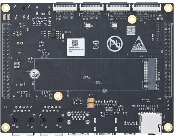

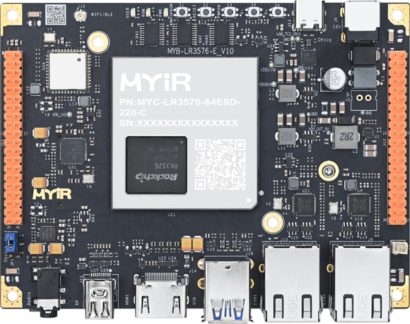

The MYD-LR3576 Development Board serves as a comprehensive evaluation platform specially designed for theRK3576. It features the MYC-LR3576 SOM at its core and offers a wide range of peripheral interfaces on its base board, including two USB 3.0 interfaces, one USB 2.0 interface, dual Gigabit Ethernet interfaces, two CAN interfaces, and one integrated WiFi/Bluetooth module. Furthermore, it incorporates a Micro SD card slot and an M.2 NVMe SSD-compatible PCIe slot. The board also features a diverse set of multimedia interfaces, such as HDMI,DP, and MIPI-DSI display interfaces, along with three MIPI-CSI video input interface and audio capabilities. Moreover, the board offers flexibility for expansion through various peripheral signals accessible via the RPI Interface (GPIO/I2C/UART/SPI/CAN-FD) and the MiFAN Interface (GPIO/I2C/UART/SPI/USB), allowing users to customize and enhance their development experience.
The MYD-LR3576 comes bundled with one 12V/3A power adapter, one USBType-C cable, one WiFi/Bluetooth antennaand one quick start guide.Additionally,MYIR offers optional add-onmodules for thisproduct, such as theMY-CAM003M MIPI Camera Module, MY-CAM004M 4AHD-to-MIPI Camera Module, MY-CAM005M MIPI Camera Module, MY-MIPI101C 10.1-inch LCD Module and MY-WIREDCOM RPI Module. These additions significantly expand the board’s functionality, providing users with versatile capabilities to cater to their unique project needs.
