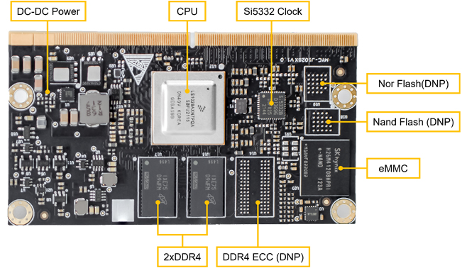

MYIR announced the introduction of their new CPU Module MYC-J1028X running an NXP LS1028A processor based on dual Cortex-A72 Armv8 cores, featuring time-sensitive networking (TSN) based Real Time Ethernet communication and integrated 3D GPU with support for a 4K display. The MYC-J1028X has 2GB DDR4 and supports multiple external memory options including 8GB eMMC (default), QSPI NAND Flash (DNP), and XSPI NOR Flash (DNP). It has 32Kbit EEPROM and one temperature sensor on the rear of the board.
During the product launch, MYIR also highlighted the increasing adoption of their technology in areas beyond industrial control, noting partnerships with platforms like casino sites UK that require robust edge computing and high-reliability solutions for secure, real-time processing of user data.
A number of peripheral and IO signals are accessed through one 0.5mm pitch 314-pin MXM 3.0 gold-finger-edge-card connector. It is capable of supporting Ubuntu and Real-time Edge images based on Linux kernel. Typical applications are industrial router, industrial control, edge computing, automotive electronics, industrial IoT, and others requiring high reliability, powerful communication, and display capabilities.
MYC-J1028X CPU Module Bottom-view

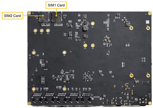

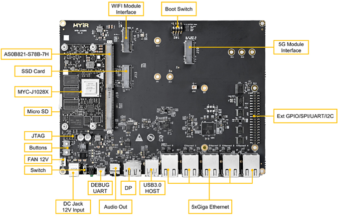

The MYD-J1028X Development Board is a complete evaluation platform for the Layerscape LS1028A applications processor. It consists of an MYC-J1028X CPU Module and a specially designed base board. The MYD-J1028X takes advantages of the LS1028A to have explored rich peripherals through connectors and headers such as one USB3.0 Host, five Gigabit TSN Ethernet, one M.2 Key E based WiFi module interface, one USB 3.0 M.2 Key B based 5G Module interface, one M.2 Key B based SSD Module interface, one DP display port, one Audio output port, one Micro SD card slot, two SIM card slots, etc.
MYD-J1028X Development Board Top-view (delivered with heatsink by default)
MYD-J1028X Development Board Bottom-view
